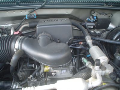

https://www.2carpros.com/forum/automotive_pictures/438838_DSC01127_1.jpg
Is this the "Spider" system?
Thanks again!
Friday, October 4th, 2019 AT 3:43 PM
JDL
  • 16,098 POSTS
Nice picture, I can't tell by the picture, my info says you have the spider system. I looked up fuel injector/s in two different parts books, they showed spider fuel system. Those systems also have trouble with the fuel poppets sticking.
