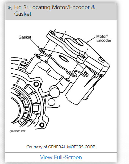

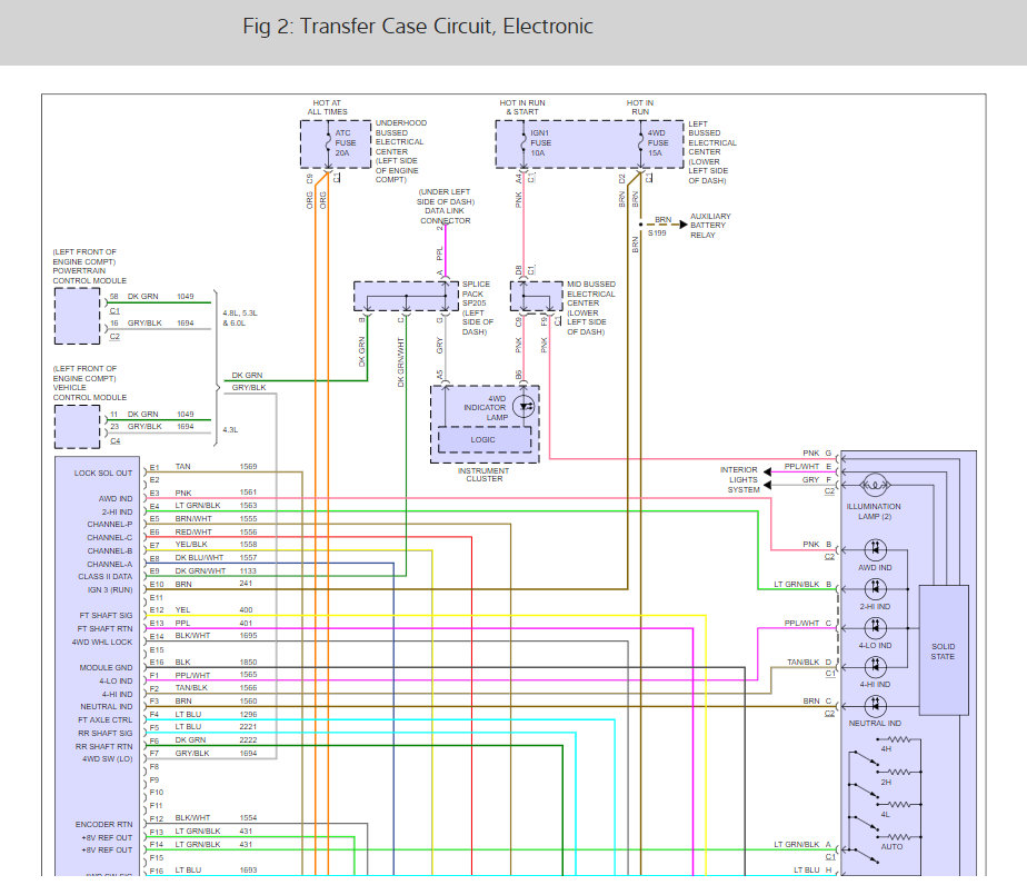

My four-wheel drive will not engage. the transfer case does not lock in and the front axle actuator does not lock in. the ATC fuse is good and so is the 4 x 4 fuse. I have already replaced the switch twice, because I have known new parts to be no good at times. the indicator lights do not come on at all, even for two wheel drive or neutral and I have no service 4 x 4 light coming on on the dash either. I have cleaned the ground on the frame underneath the driver's door and the ground from the firewall to the engine block. I am beginning to think the module itself is bad, but I would prefer not to just throw expensive parts at this.
I would even settle for a way to rig up four-wheel drive high with toggle switches if it were possible. can anybody help?

Hello,I'm Danny.
Have you tested the front differential actuator? That has been a huge problem for this. I've attached a picture below show on the front differential where it's located. Hope this helps and thanks for using 2CarPros.

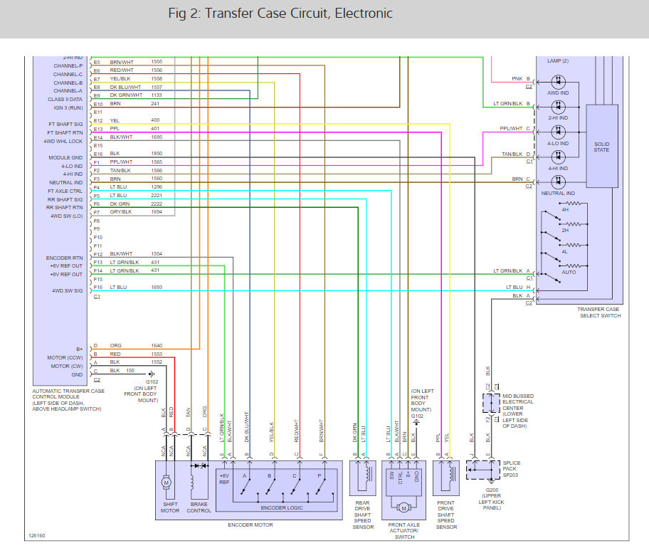

Can we test for power at fuse ITC. IG1 and 4WD. Here is a guide to help us see and the fuse locations below along with the wiring diagrams so you can see how the system works. Also here is the encoder location.

Using your diagrams I found that I did not have power to the orange wire on the plug with the encoder motor control wires when I Supply that wire with power I got it to shift out of 2 wheel drive into 4 wheel drive however now it is stuck in 4-wheel drive high or automatic four-wheel drive and will not shift back out and now my service 4X4 light is on

Do you have power at the ATC fuse? 20 amp.

Yes, I had power there before but it was not making it to the module. However, now when I go to shift it I can hear the encoder motor making noise but it does not shift out of 4x4.

  • 54,350 POSTS
I would remove the encoder and then with it our move the switch and watch it work to make sure it is working properly. They can make noise but be weak which sounds like what it happening. Can you please shoot a quick video with your phone so we can hear the noise? that would be great. You can upload it here with your response.
