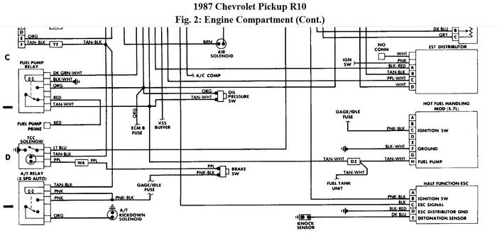

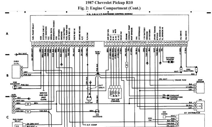

  • 75,992 POSTS
The fuel pump will only power up for 2 secs due to the fuel pump relay de-energizing. The computer energizes the relay thru its fuel pump control
Have you tried direct power to the fuel pump? If it comes on when direct power is use and the relay has been replaced. Test the wirng-wiring okay, Test computer fuel pump control and fuel pump and oil pressure sending unit.
+4

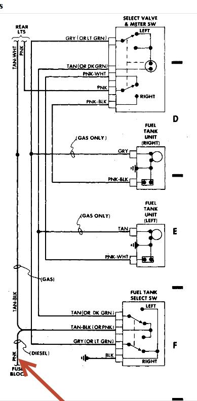

PLUMBED1
  • 1987 CHEVROLET SILVERADO
  • 142,000 MILES

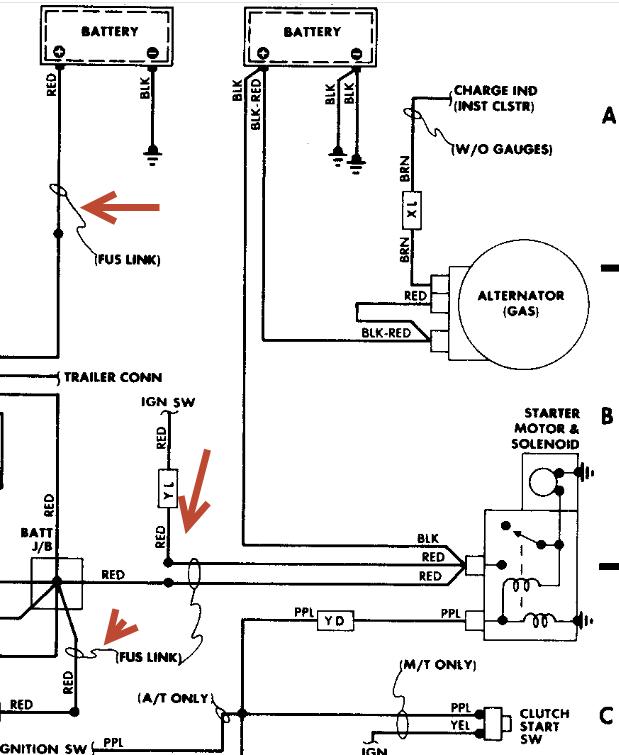

I am attempting to trace why I am only getting 8.4 volts to my dual tank switch on my 87 R30. I have ohmed all the fuses, checked every ground I can find, have jumpered 12 volts directly through the switch, switch connection, and both relay's and got 12 volt's to the fuel pumps, which work fine. I am currently trying to locate a fuseable link that I read about behind the gauges. Have yet to find this mystic wire. Any suggestions?
Tuesday, July 7th, 2020 AT 1:38 PM (Merged)
HMAC300
  • 48,601 POSTS
Most fusible links on that year are attached to the starter under the manifold. If you rlinks were bad it could cause this but it almost sounds like a wire is grounding out partially. The pink wire leads to the fuse box off of the ign switch. See diagrams
+2
PLUMBED1
Thank-you for the response. If I find the problem based on your advice I assure you that I will make a donation to this web site. You are the only one out of ten responses from other sites that have made any sense. I will be sure to let you know the results.
Dan
+1

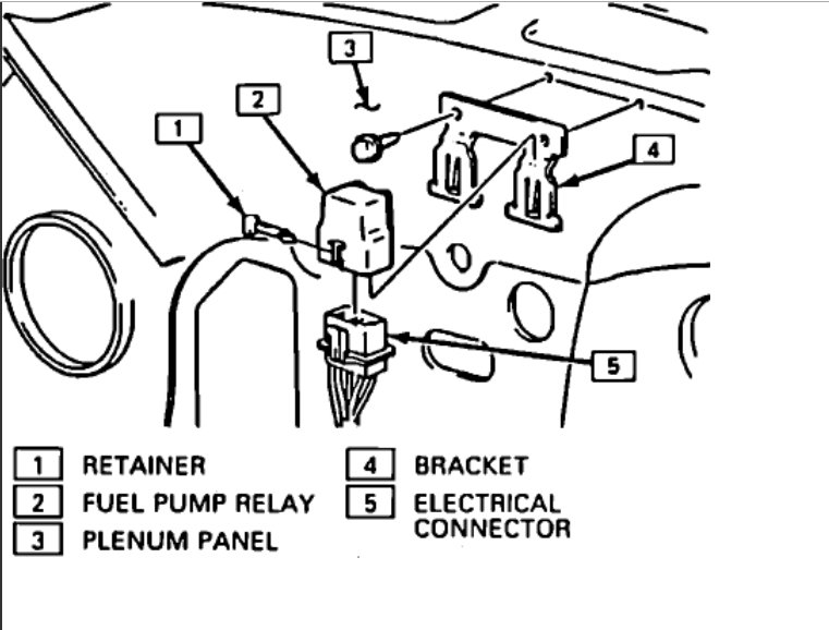

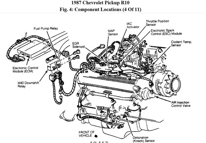

  • 75,992 POSTS
The fuel pump gets its power from the gray wire the black is ground.
The fuel pump relay only works for 2 secs. and its energize by the computer
below is the fuel circuitry
https://www.2carpros.com/forum/automotive_pictures/12900_pump_wiring_1.jpg
https://www.2carpros.com/forum/automotive_pictures/12900_oil_sending_unit_and_fuel_pump_circuit_19.gif
