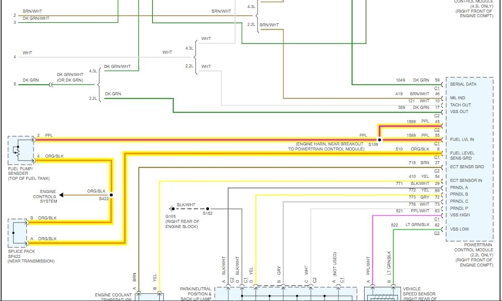

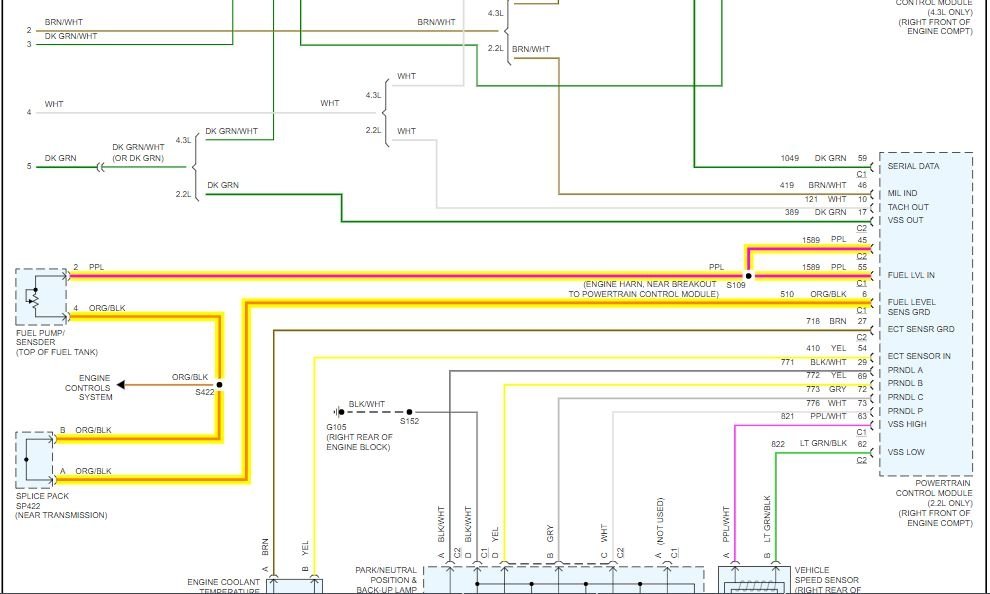

I have a 2000 s-10 4.3 with 11,500 miles on it. The fuel gauge reads inaccurate, always reading full, when it's not. It moves a little bit off full, but not accurate. Also, when i am at a stop light for more than a few seconds it buries the needle to E, once i tap the gas it goes back to full. thanks for the help.
Nov 9, 2007 at 9:33 PM
  • CAR REPAIR CONTRIBUTOR
Good evening,
This could be the fuel sender unit in the tank, wiring or the cluster.
You will need a volt meter to test for voltage back at the tank to verify voltage to the sender.
