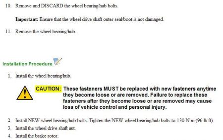

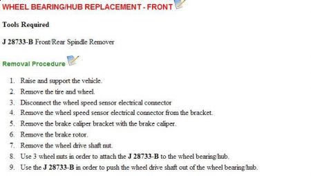

2002 Chevy Monte Carlo Two Wheel Drive Automatic 215000 miles
How do you replace the front wheel bearings.I have no clue where to start well atleast after I take the wheels off
