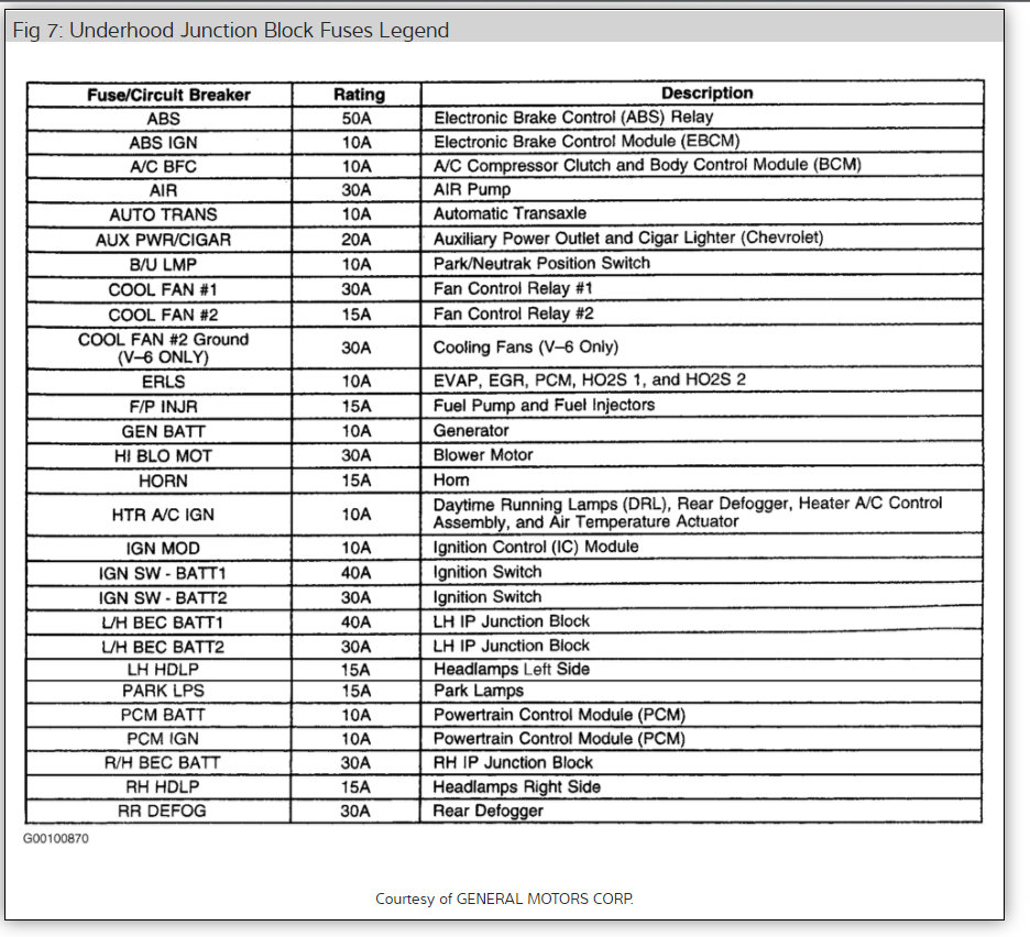

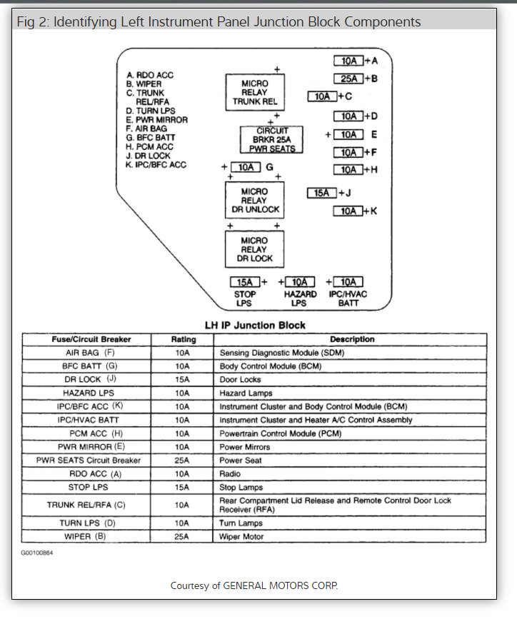

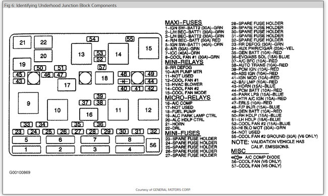

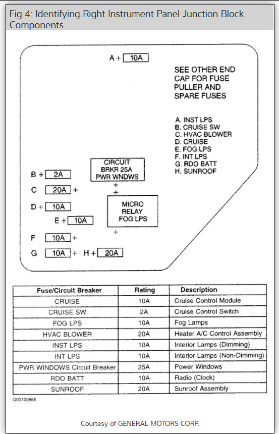

All 4 of my windows just stopped working. Checked and seen no fuse for the windows, assume they are controlled by a relay or circuit breaker. Dont have a car manual, so not sure the location to look and find either of the two. Windows not working can someone please help me out?
Friday, March 23rd, 2012 AT 4:55 AM
22 Replies
FIXITMR
  • 9,990 POSTS

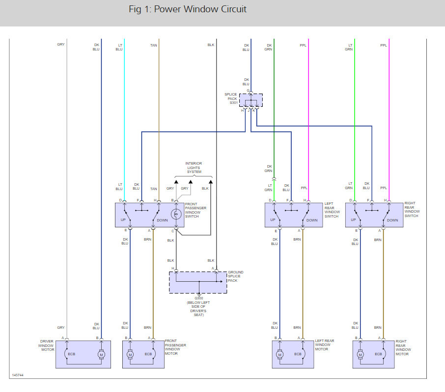

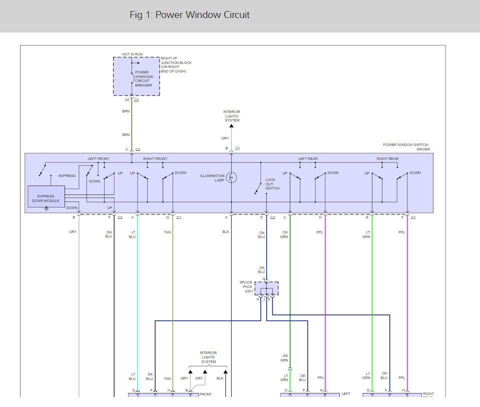

Here is a guide to help you test for power and the breaker and the fuse and breaker locations below with the wiring diagrams so you can see how the system works.
This guide can help as well
https://www.2carpros.com/articles/electric-window-repair

You need to test the switch, and the motor, test the motor by removing the trim panel, unplug the motor connector, activate the switch, in both directions while testing the leads with a volt meter, or test light. If the light comes on, the problem is the motor, if not the wiring or switch is bad. Replace motor this way.

Without checking, my first guess would be the main switch on the driver's door. Check for power to the rear motor and front. Let me know if there is power. If there isn't, replace the switch.
