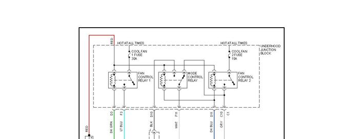

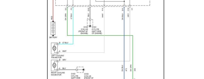

There are some relays that control the fans. Here are some diagrams that will help you fix the problem.

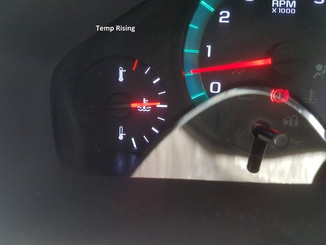

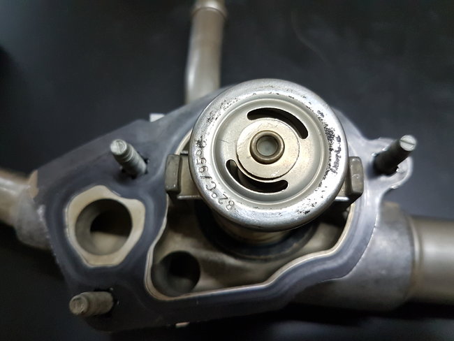

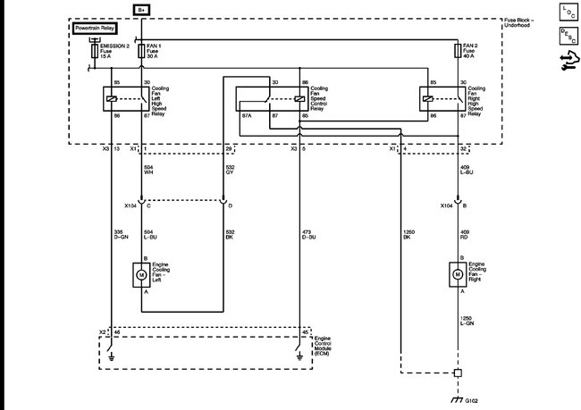

I have Traverse 2012. Temperature gauge is going little up and then come down. This situation occurred in heavy traffic or vehicle is not moving. I changed the thermostat but no luck.
I used the scan tool (elm) when temperature reached 105C then fans turn on. speed is same as i turn on the AC. So it means fan is not running on 95C which is slow speed fan.
What is the solution?

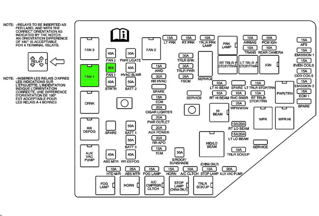

First item I would check would be the low speed fan relay number one and its fuse. If both are good then check that relay three is working as it passes the power through to the second fan. If that is okay as well follow the wiring from the fan and look for any broken or rubbing wires.
The system works by first turning on both fans as a series circuit using relay 1. That feeds battery voltage through both motors and they turn at low speed. Once the temperature threshold rises the ECM then triggers relays 3 and 2. Relay 3 now creates a direct ground path for fan one and relay 2 powers up and feeds full battery power to fan 2.

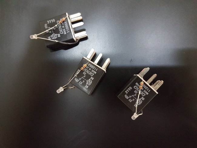

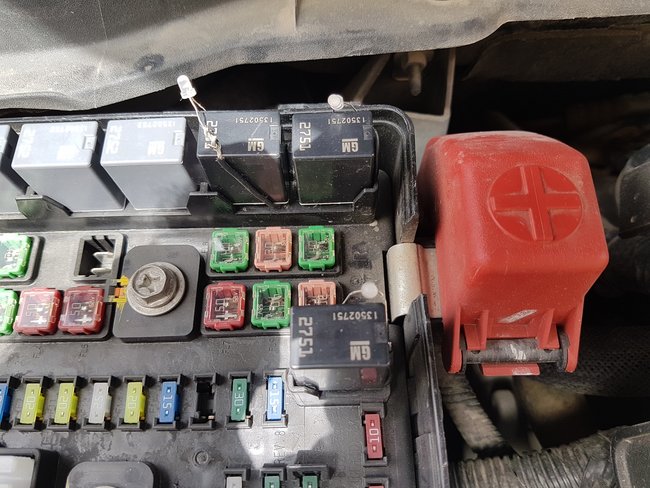

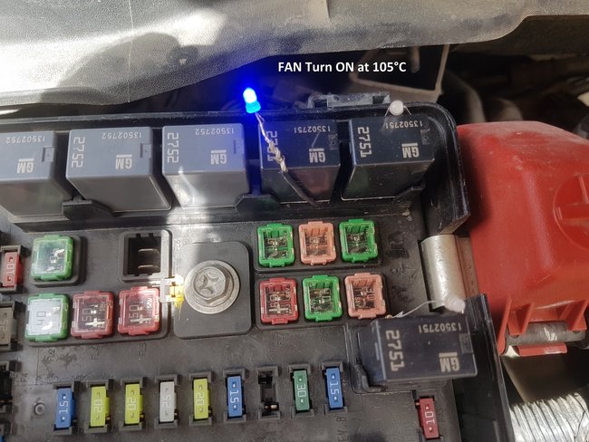

Yesterday I used LED's on fan relays to check the behavior.
When temperature reached at 105C then relay one turn on and fan also turn on. I removed relays one by one. Only FAN2 relay is not changing the fanbehavior. See the image.

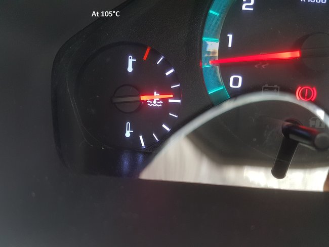

My friend has Acadia. I monitored his car temperature through scanner. When temperature reached at 105C fans turned on but temperature gauge is steady. So it has prove that my Traverse is not overheating or fans are switching on delay. Now problem is gauge is moving when temperature rise 103C. Is it gauge problem or some thing else?

Normally the fan operation will cause the temperature to cycle and the fans cycle with it. So the temperature rises, the fans turn on, this cools the system to a temperature below the on temperature and the fans go off. The coolant then absorbs more heat and the fans come back on. The temperature gauge should cycle with it. Unless there is an issue with the cooling system the temperature shouldn't stay steady like your friends. It should normally cycle.
May 5, 2018 at 6:46 PM
MFAROOQGUL
If fan turns on normal temperature which is 105°C then gauge should be steady. If gauge is rising after the fan switch on and temperature is also increasing then we can say it is cooling system problem.
May be Traverse normal temperature is 100°C or ECU is giving wrong value to temperature gauge. It all happened after cleaning the throttle body, I do not know it has some link or is a coincidence. :-D

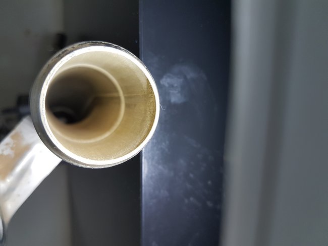

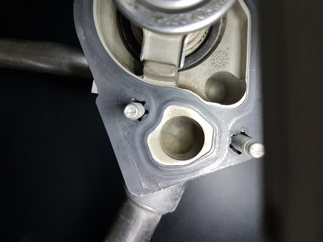

It is hard to believe that problem is in cooling system, check the image of thermostat which I replaced, it is clear like new. No rust and dirty and I filled proper coolant.
What should I do to diagnose this problem? Temperature sensor can be a problem?
