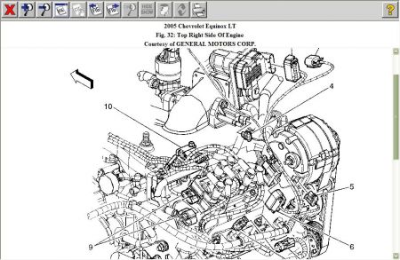

where is the map sensor located and are there more then one on this model?

You have one. See item number 10 below.

MAP sensor is located at the top of the intake manifold.
MAS S Air flow sensor is located in the air way between air filter and throttle body.
