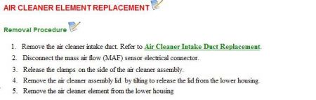

How do you repalce the air filter

Engine or the cabin air filter?

Engine air filter
