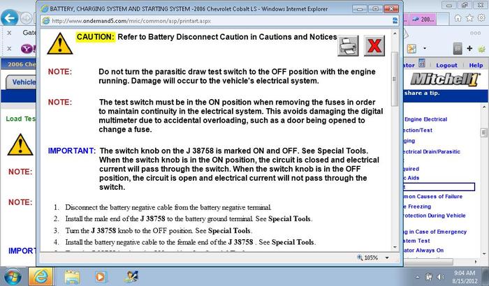

Mv is a voltage reading not a amp drain reading. How are you doing your parastic draw test?

I always do at the battery cable where it attaches to the battery. You break the connection to battery and measure milliamp draw not voltage. Measuring a draw from the body control module can be tricky.

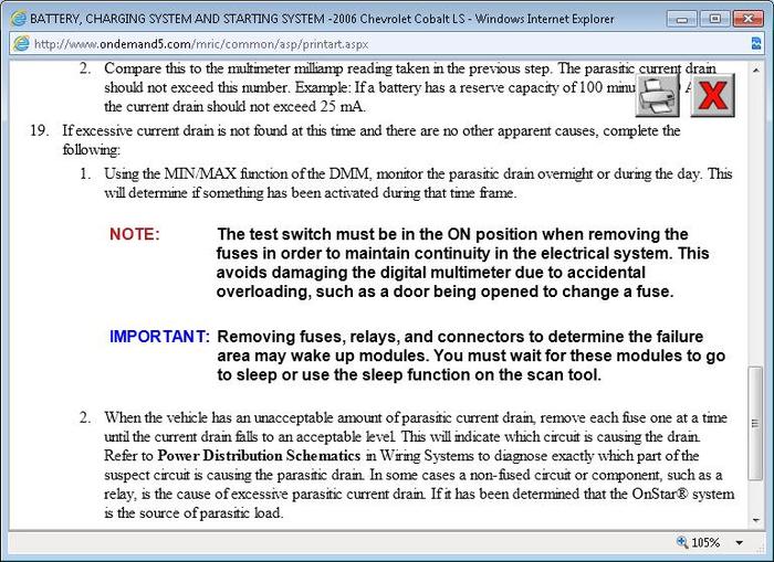

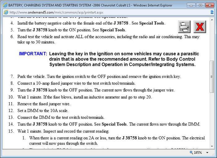

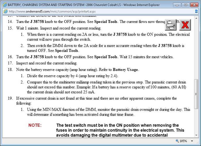

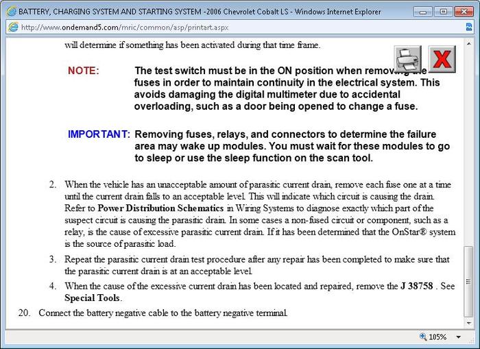

I posted the way chevy wants you to measure and test for a draw. Let me know what you find.

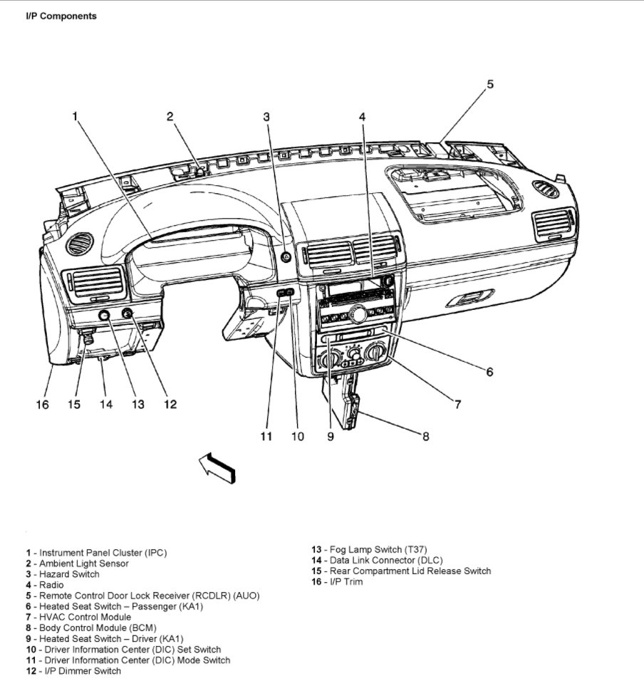

The problem was caused by the BCM not going into sleep mode which keeps the electrical system alive which makes the battery drain. You will need to have a garage reprogram the BCM once it is replaced, Here is its location (below)
Please let us know what you happens.
