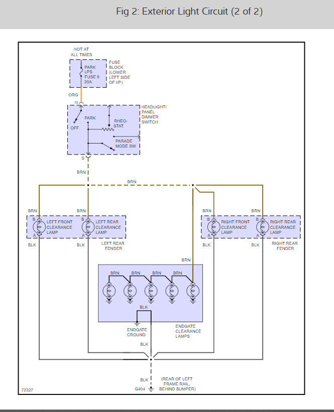

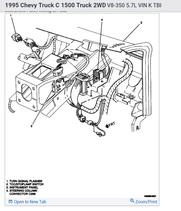

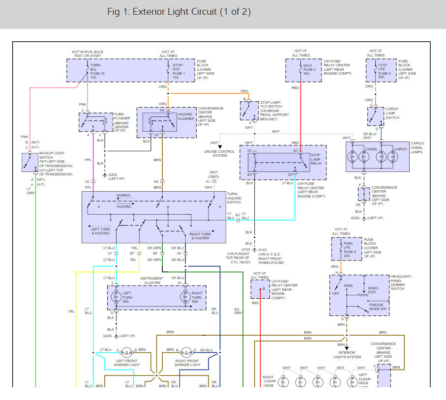

It could be defective flasher here is its location to make sure you are changing the right one also here are the blinker wiring diagrams so you can see how the system works as well.
Check out the diagrams (Below). Please let us know what you find. We are interested to see what it is.

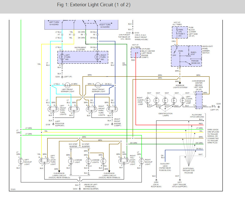

I tried 3 different new turn signal flashers, hazards work fine!. Note that when I say I wired a trailer, the truck already had a four prong trailer plug on it so I did not wire the truck, just wired trailer lights on a trailer and connected 4 prong to the truck existing 4 prong.

I disconnected trailer wiring and fuses seem good. Again, hazards work, reverse and brake lights work. If I press down hard on hazard light button and hold, turn signal flasher clicks!! and not sure why since there is a seperate hazard flasher and turn signal flasher

Check for voltage coming into turn signal switch purple wire(12volt), if ok activate turn signal, looking for voltage coming out of turn signal switch on either light blue or yellow (left signal). or dark green/dark blue(right signal). If you have voltage on purple wire and nothing coming out on the mentioned wires, suspect turn sig. switch

I fixed it the turn signal switch has bad! thanks for your help on this I love this site.
