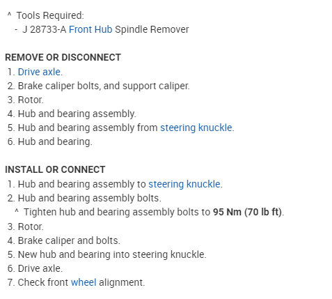

Is it difficult to replace the bearing on my own. I have replaced alternators and starters. But didn't want to get into something that may require certain tools.
Jul 5, 2008 at 11:37 AM
SQM
  • CAR REPAIR CONTRIBUTOR
  • 6,383 POSTS

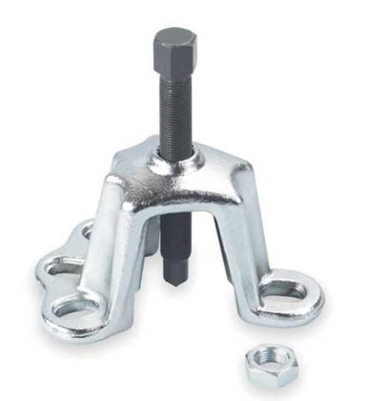

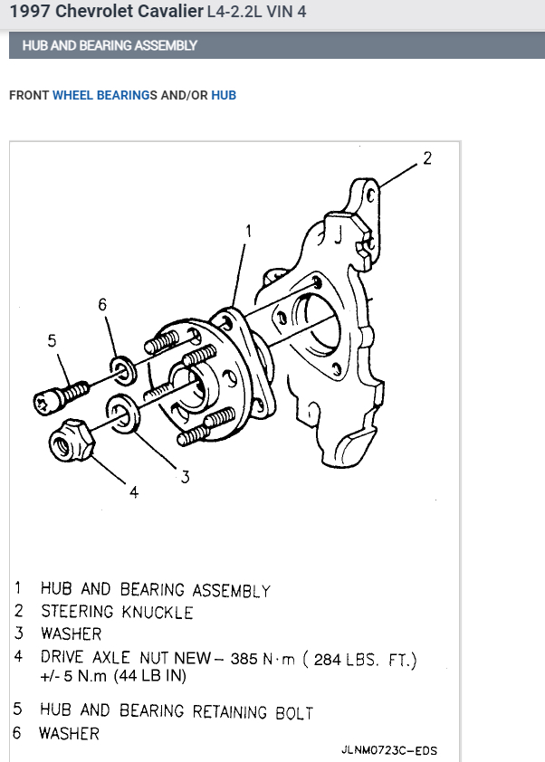

The wheel bearings can be replaced quite easily. You will need a hub puller to pull the bearing hub off of the vehicle. This tool can be rented from your local auto parts store (see picture).
Here is a helpful guide:
https://www.2carpros.com/articles/bearing-hub-replacement
