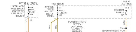

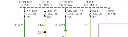

my speedometer and radio and blower for heat and air is not working. i went over a dirt road it was pretty bad. have washboard when i went over it.

For the radio and blower motor, check applicable fuses. Not only check fuse, use a voltage tester at the fuse circuit to check for voltage, some fuses go hot when you turn on the key. I haven't looked at your speedometer, yet.
https://images.2carpros.com/forum/automotive_pictures/170934_heater_fuses_1.jpg
https://images.2carpros.com/forum/automotive_pictures/170934_radio_fuses_1.jpg
