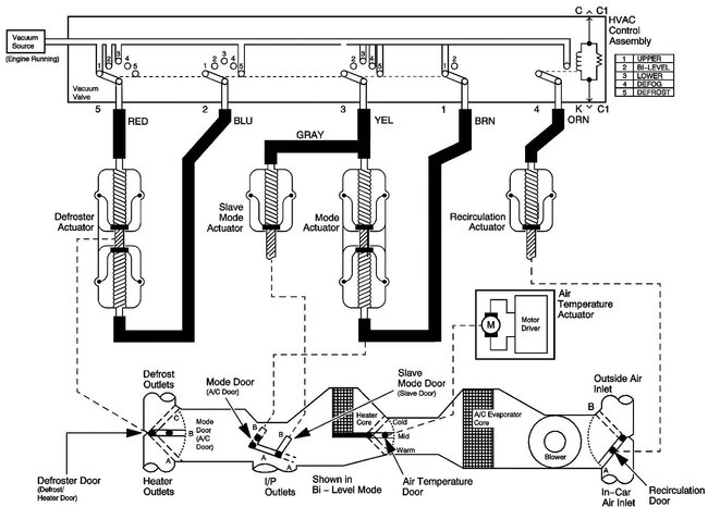

Hello. If memory serves, there's a vacuum line under the dash, drivers side, nearish to the console. This line gets disconnected when you pull the dashboard back to get to that heater core. Make sure it is connected. Then start the truck and put the HVAC on Max A/C mode and let it run for a minute. Now check to see if there's anything coming from the floor vents. Hopefully this takes care of your problem. I tried to get you a diagram but can't seem to locate one on AllData.

Does moving the mode control do anything? IE put it on defrost it switches to defrost or to the dash it blows out the dash? This is the vacuum line diagram, unfortunately it doesn't show the actual routing of the lines. Your description sounds like the main vacuum line is off but there are a few that can cause problems.

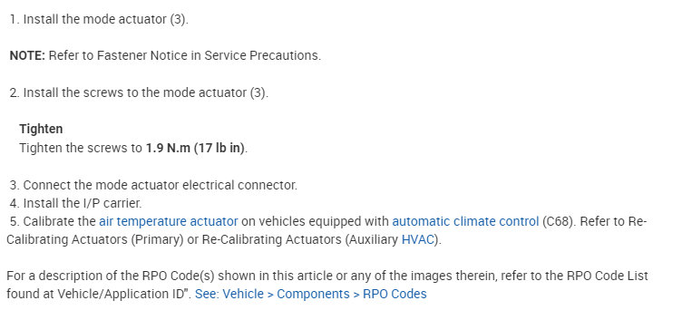

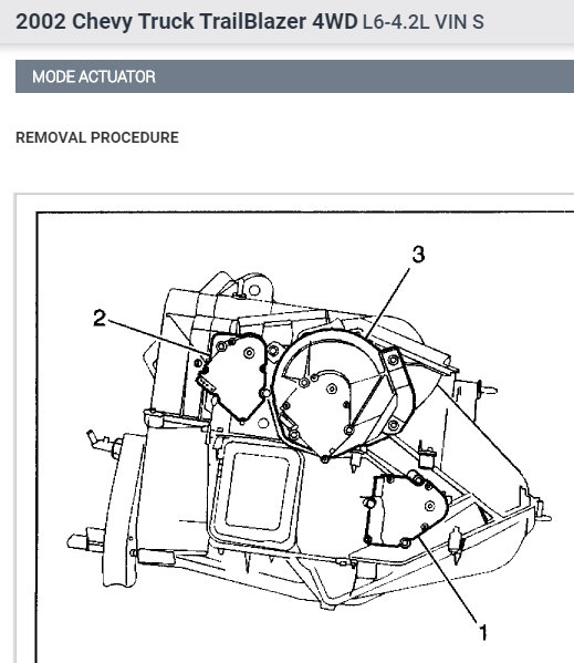

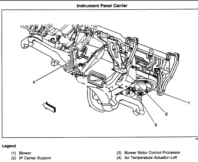

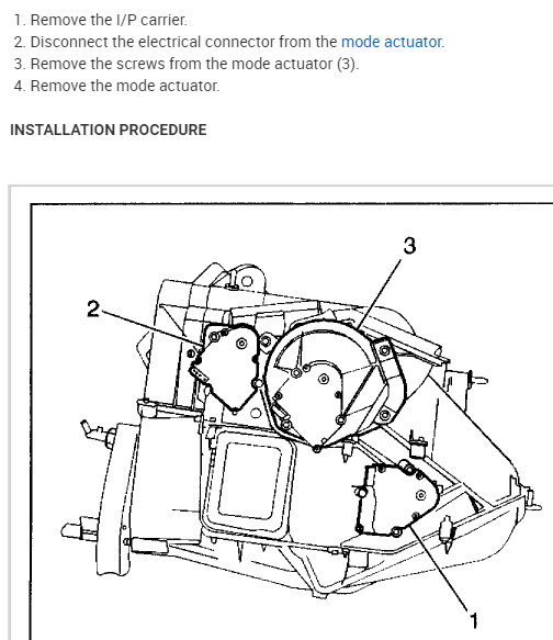

Here is a tutorial showing what is involved for the blend/mode actuator:

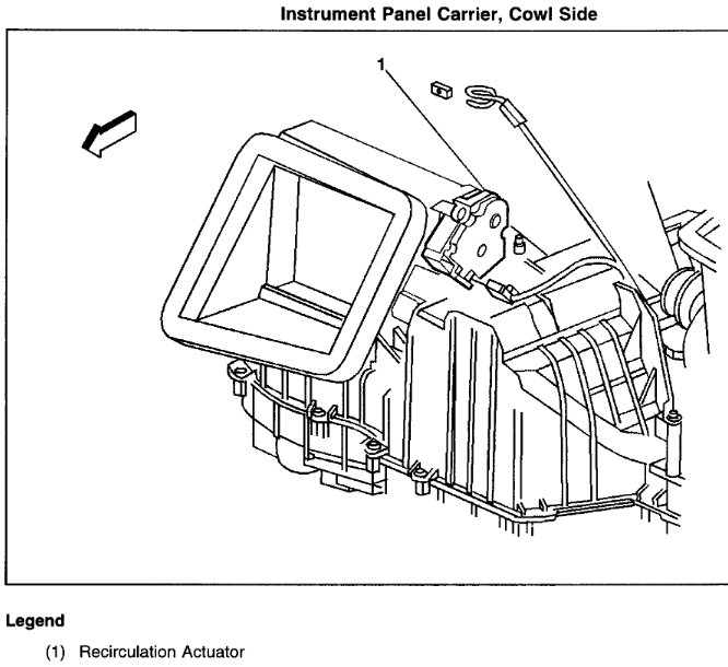

This is an electric motor that opens/closes to direct air flow through the proper ducts. I've attached step- by- step pictures below including the location on the HVAC box under the dash board.Hope this helps and thanks again for using 2CarPros.
Danny-
Dec 29, 2020 at 8:57 AM (Merged)

Danny, thanks for the information. checked in the glove box area, and mind is in the back, looks like I have to pull the dash to get to it. also, i see that it is facing up in mine, as I went to the junk yard and there was a dash already pulled out. This looks like it is going to be fun to do. The images you sent were for another vehicle not mind. any ideas on how to get to the problem??

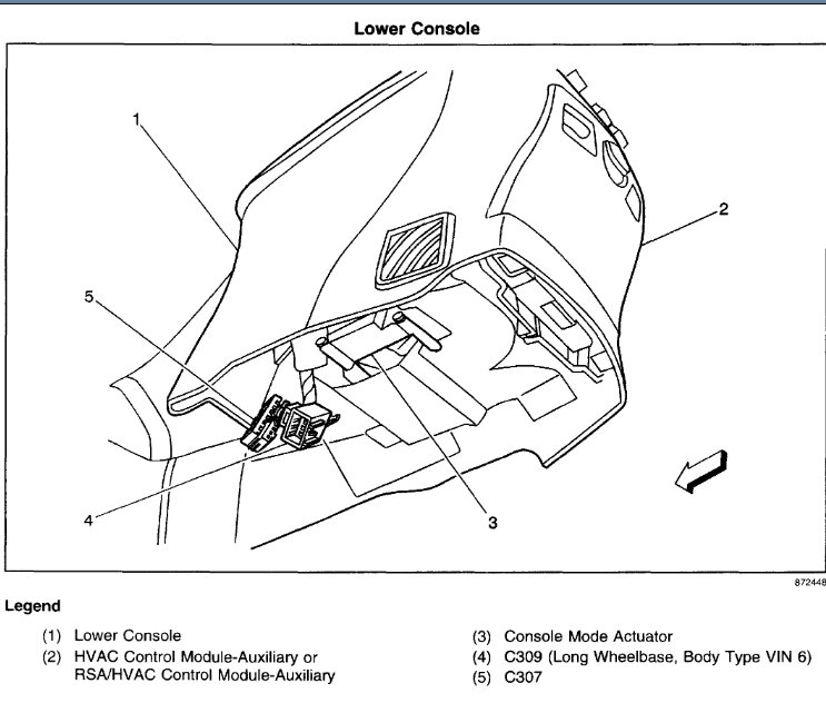

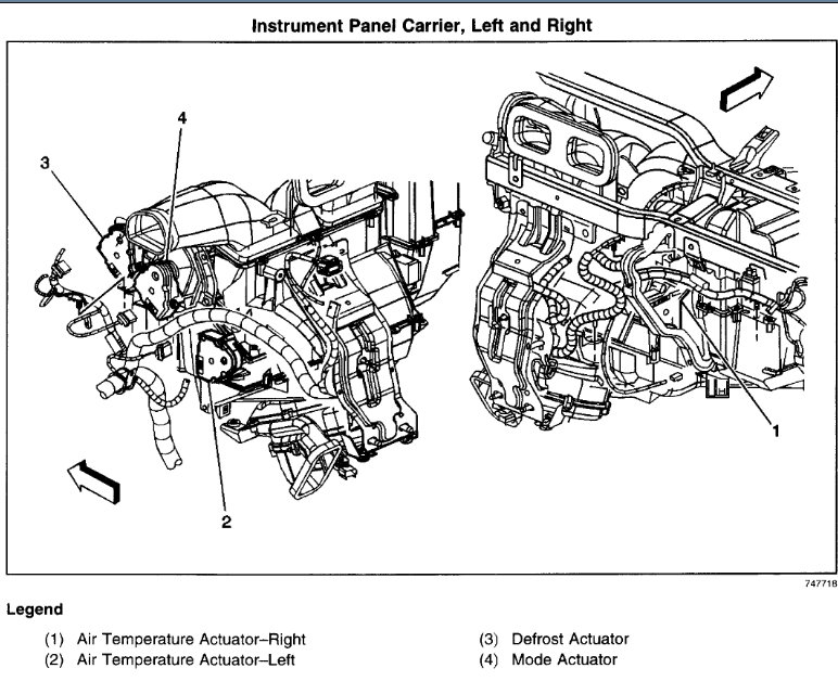

DANNY L
  • CAR REPAIR CONTRIBUTOR
  • 5,648 POSTS
Hello again.

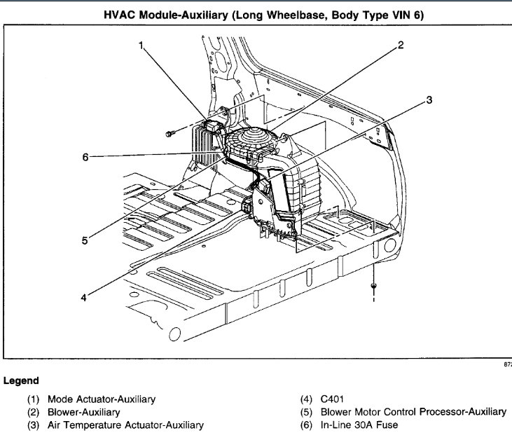

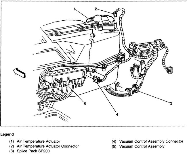

I attached the picture of the mode actuator prior which sounds like your problem. However, I'm attaching more pictures of your HVAC system so let me know if anything in the pictures are what you are talking about with the junkyard dash and I'll get back to you with more information. Hope this helps and thanks again for using 2CarPros.
Danny-
