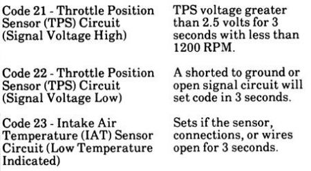

93 chevy s-10 blzer tahoe, i don't have a repair manuel for it,and none of the parts stores can find the codes that far back.all they have is obd2.my codes are 21 22 23.if you could help it would be appreciated.by the way it's 4 wheel drive with 4.6 liter engine.

Hello, is the vehicle running ok? Any driveability issues? The generic chevy blazer info shows this.
https://images.2carpros.com/forum/automotive_pictures/170934_93_chevy_blazer_1.jpg
If you have done a lot of modifications???
