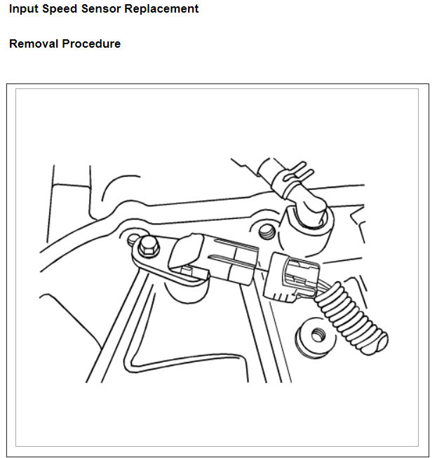

The hold light flashes then the air conditioning stop working. If we unplug the battery for a few minutes then plug back up everything resets and works for a few days then does it again.
Friday, August 16th, 2013 AT 11:52 AM
4 Replies
HMAC300
  • 48,601 POSTS

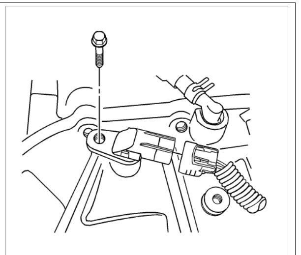

This problem has nothing to do with the ac. If any sensors stop working on engine the computer shuts off a.c. and flashes HOLD light. The hold light flashing is the issue which usually means the turbine speed sensor needs to be replaced.
To be sure lets run the codes
Here is a video showing the job being done with a diagrams BELOW to show you the location on your car.
https://youtu.be/f3bETtCIdxM
Cheers

I had this problem and the shop replaced the sensor unit for $240.00 but at least is working again.
