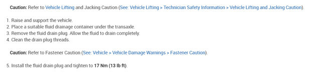

Change out the transmission filter, would I simply drain the existing oil-take off old filter-clean area-replace seals-put in new filter-screw pan into place-then fill with tranny fluid. And how much transmission fluid should I put in. Also will all the fluid be removed or just a partial amount.

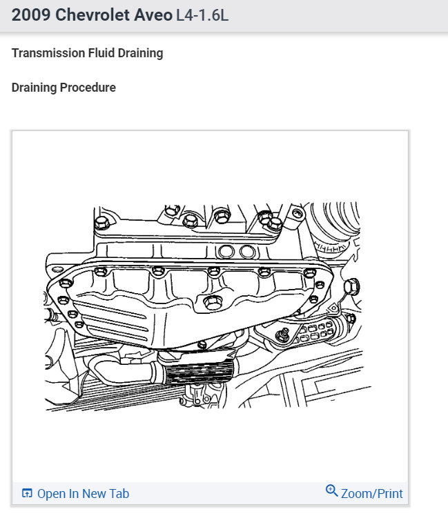

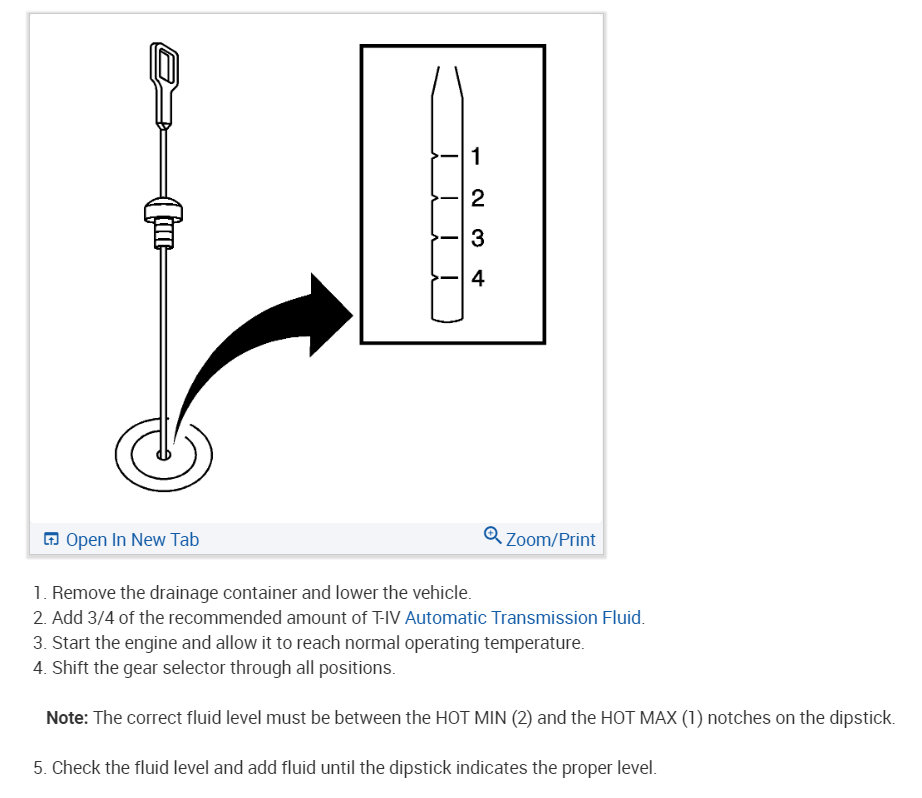

Here is a guide to help walk you through the transmission service and diagrams below to show you how on your car.
Fluid Types
AUTOMATIC TRANSMISSION
Use only T-IV Automatic Transmission Fluid (GM Part No. U.S. 88900925, in Canada 22689186).
Capacities
AUTOMATIC TRANSMISSION FLUID
Drain and Refill .................... 2.1 liters (2.2 quarts)
Note: All capacities are approximate. When adding, be sure to fill to the appropriate level. Recheck fluid level after filling.

It holds 6.2 quarts of type T IV trans fluid just look for that type on can at auto parts. If it is leaking or using transmission fluid then check coolant for having oil in it the cooling line inside radiator may have broken and that is where it probably is going. Your coolant tank may have an oily film on inside. Otherwise there would be some type of oil leakage if external. When checking fluid do it with trans hot and fluid level should be between one and two.
