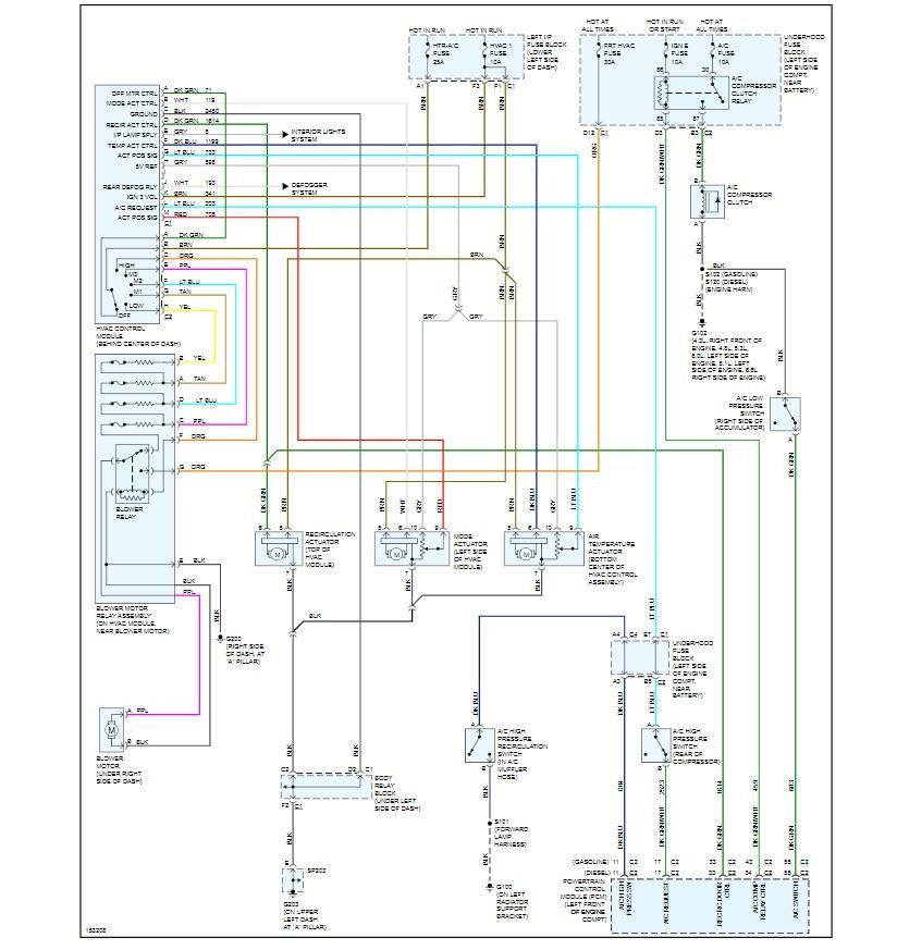

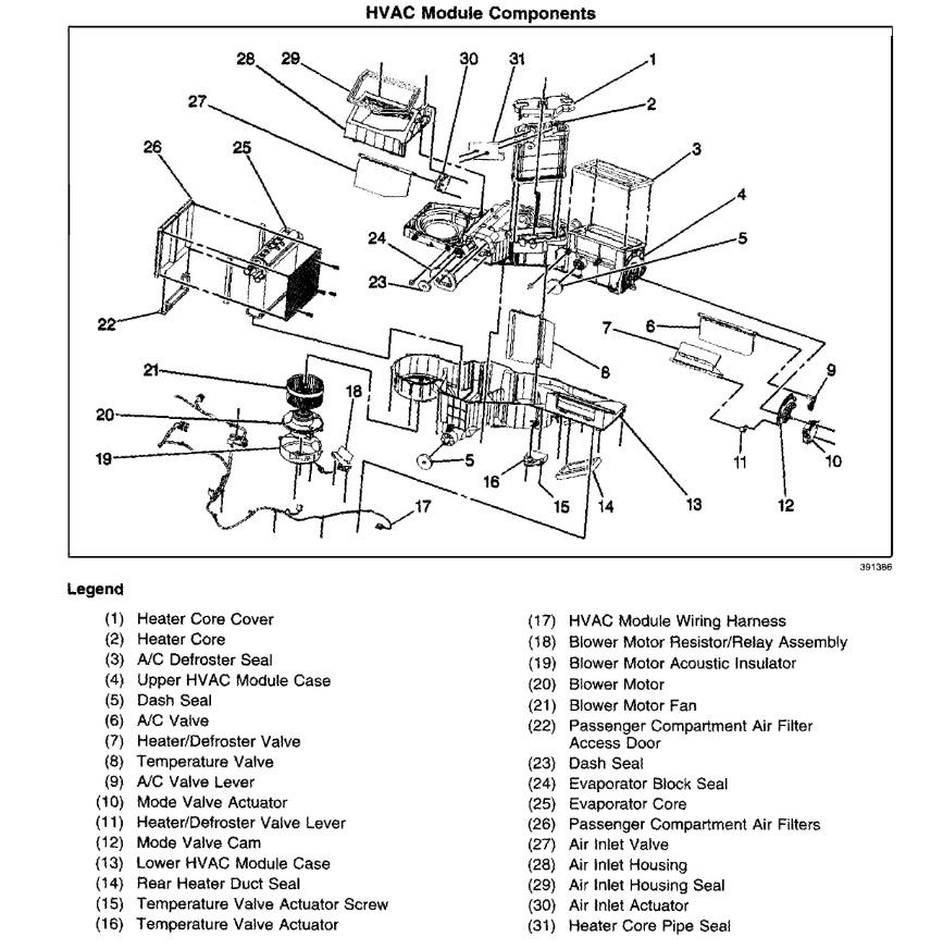

The most common cause is the mode doors are operated by electric motors (actuators) that go bad. Attached below is a guide for blend door actuator replacement.
Here is a video of actuator replacement on a Silverado:
https://youtu.be/Eqf-H3COtSo
All of the locations and diagrams are attached below.

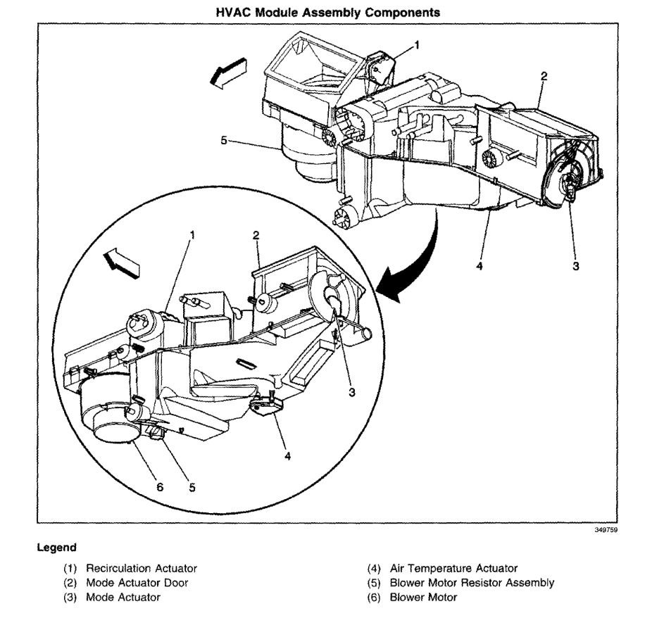

The mode door control is an electric motor actuator that rarely act like that. You will have to examine the mode actuator during this problem to see if the motor is actually doing that or if there is broken or disconnected linkage there. The mode control will be on the left side of the HVAC housing.

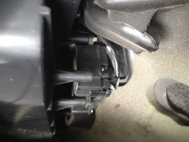

Thank you, actually the blend door actuator is under the glove box on the passenger side, but I thought that was just to adjust heat from cold. Is there another? Please see pictures.
Thank you again!
Monday, September 24th, 2018 AT 6:40 PM (Merged)
WRENCHTECH
  • 20,758 POSTS
Yes, you are right. The Blend door actuator is on that side but I never said anything about a blend door. I told you to check the mode door actuator. Which is on the left side.

If this happened after disconnecting the battery, this is what happened. Every time the power is cut off the system loses memory and when the power is reconnected the system goes through a calibration process that moves all the doors to their extreme ends for calibration and many of them will get stuck when that happens. It very common on the temp doors. It may unstick itself and you may be able to help it along by pushing on the linkage under the driver's side dash.
There are no vacuum controls on this system.
