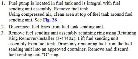

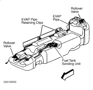

Please explain me how can I remove fuel pump
