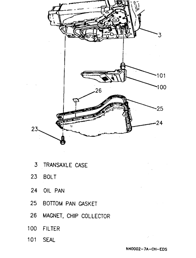

I have a 1997 Buick Lesabre with a 3.8 liter engine and automatic transmission. It has 79,000 miles on it. When I accelerate in the first gear it grabs and pulls fine but when it shifts to second or other gears under load it has started slipping and shuddering. It also seems to shift a little harder. The problem showed up yesterday. Three hundred miles ago. I replaced the transmission fluid and filter and it all looked great in the pan with no metal filings or debris from drive bands. The fluid level is fine. I checked it several times on level ground and after it warmed up. I replaced the fluid about three hundred miles ago with Dexron Mercon III. Can anyone tell me what the problem may be? Thanks for any help. Mark Cigainero

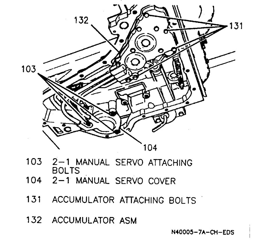

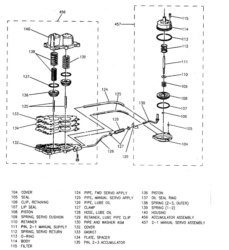

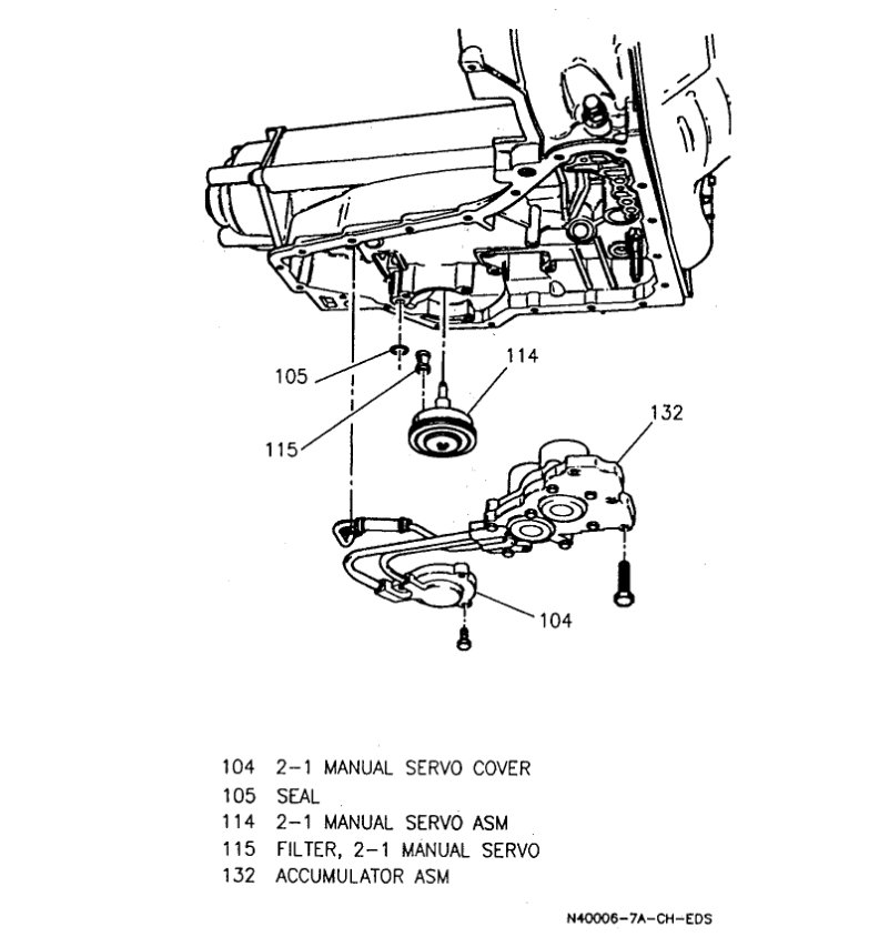

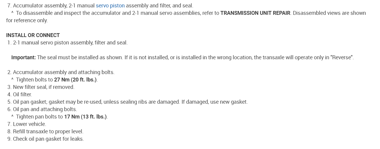

This sounds like the transmission has a accumulator seal that is leaking. Here is a guide to help you remove the pan and diagrams below to show you what to replace:
Cheers

You could have a PC solenoid issue causing the harsh shifting, and burnt second gear clutches causing the shudder. First, check the transmission fluid and make sure it is still clean and full.
