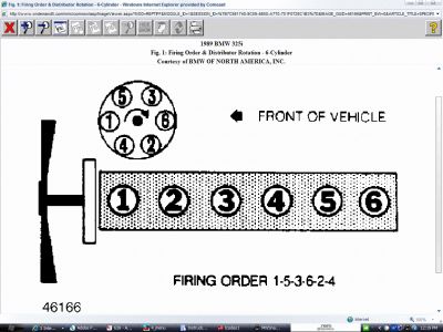

I need to know the firing order a 89'BMW325i, and what the original spark plug make, and type.

Bosch W8LCR plugs

All inline sixes fire 1-5-3-6-2-4
