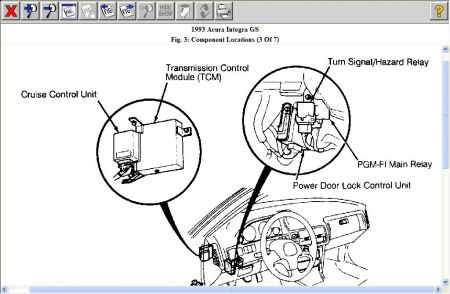

Engine sart but, fuel pump dont run and injectin dont run to
Tuesday, September 8th, 2009 AT 5:43 PM
KHLOW2008
MECHANIC
41,814 POSTS
Hi slaughter009,
Check the PGM-FI main relay. Known to intermittently cause non starting when it fails to operate the fuel pump.
