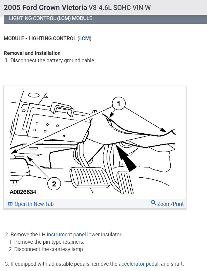

My headlights and high beams will turn off at random times. All my other lights work, and the high beams work if I manually hold the high beams toward me, but you can see how this is a real problem at night. I haven't been able to go anywhere after dark because they are so unreliable. What is the problem?
Tuesday, December 28th, 2010 AT 5:15 PM
43 Replies
WAY2OLD
  • 195 POSTS

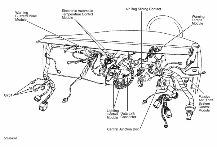

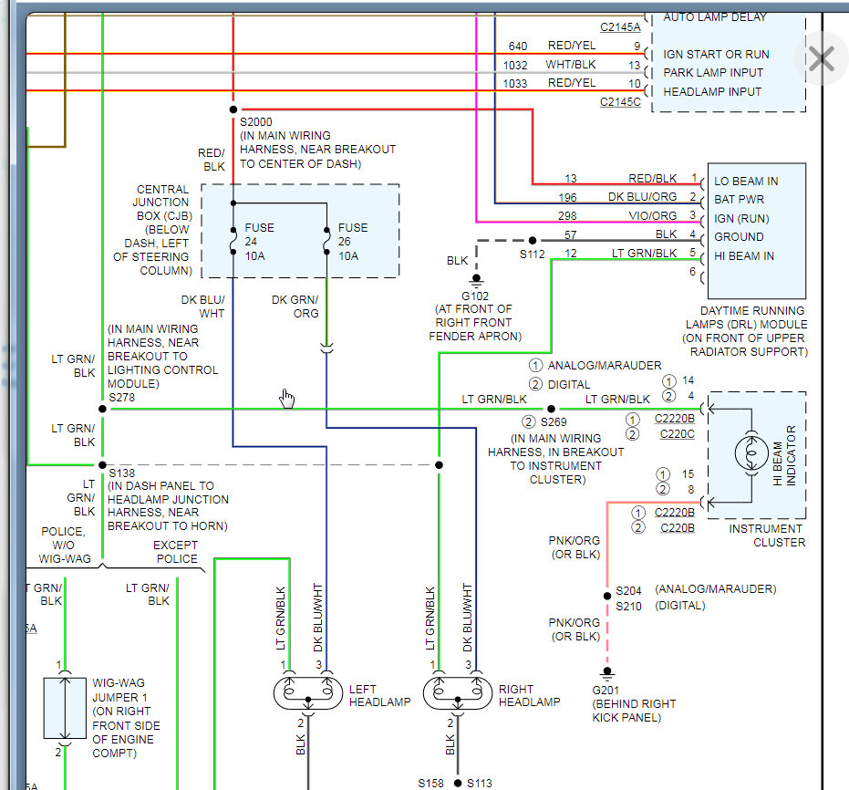

These cars have a lighting module that goes out here is the location so you can check it out. Check out the diagrams (Below). Please let us know what you find.

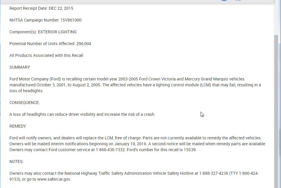

The front lights stopped working after 2 months after the recall (bypass). Could the LCM Relay be wrong or what does the bypass remove the relay?
Wednesday, May 19th, 2021 AT 6:45 PM (Merged)

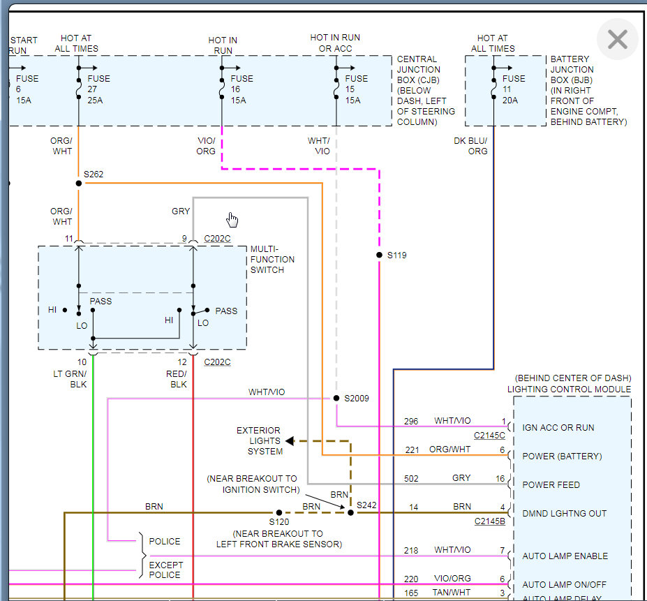

When they did the recall did they replace the LCM? If not, it looks like the repair did not correct the concern. So it is rare but there are times when the dealer does not do the recall correctly. Maybe they put a new tech on it and they didn't understand something but it is pretty clear that this is a known issue.

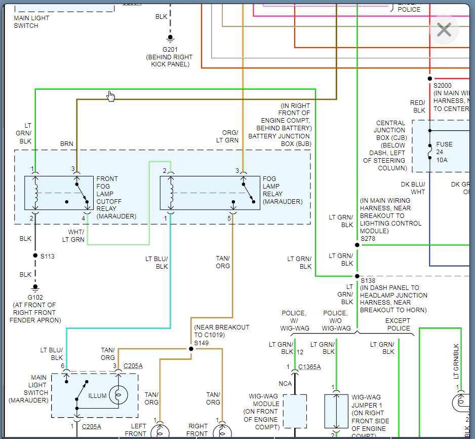

I would take it back to the dealer that did the repair however, below you will find the wiring diagram of your lighting system if you want to test the power coming out of the LCM.
Here is a guide that will help with this:
I would test the wire coming out of the LCM going to the switch to see if there is power. If not then the LCM is the issue.
Let us know what questions you have. Thanks

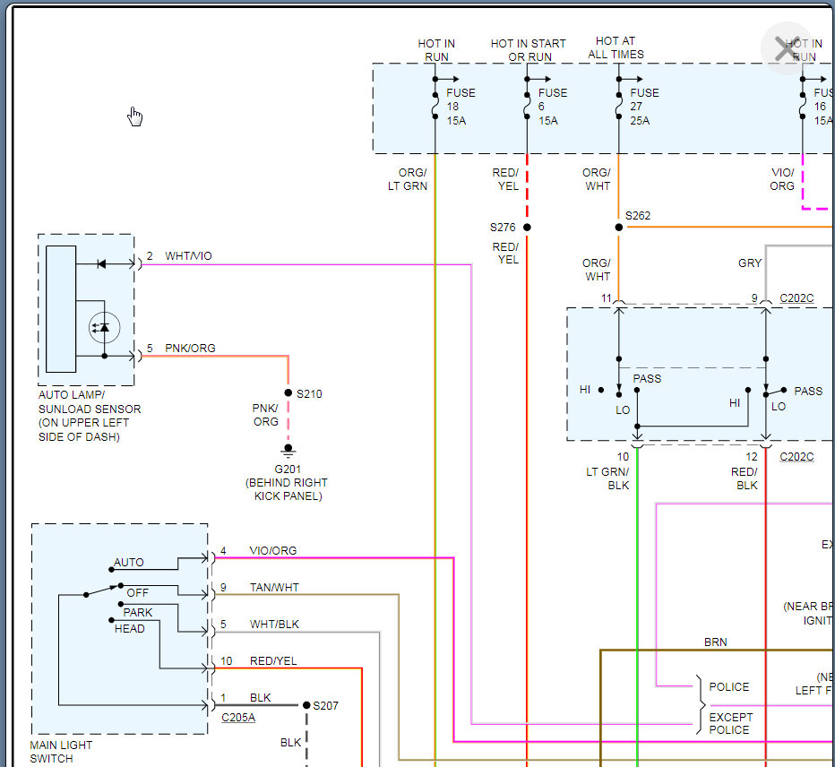

The Light Control Module for this model has a high rate of failure and some geniuses have come up with a solution for this by bypassing the it.
Using a 4 pin relay connect as follows at the LCM (light control module).
Tee in orange/white wire at lcm (bat +) to pin 30 & pin 85 of relay.
Tee in red/yellow wire at lcm (headlamp input) to pin 86 of relay.
Cut gray wire at lcm (power feed to multi-function switch) cover gray wire from lcm with tape - connect gray wire from multi-function switch to pin 87 of relay.
Test the operation.

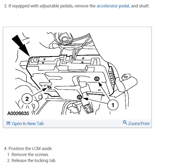

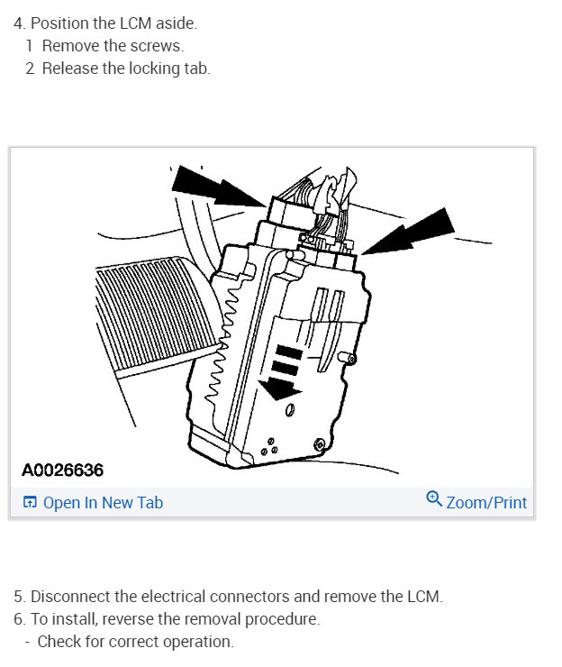

DAVE H
  • 13,383 POSTS
Check/replace the lighting control mdule..
Lighting Control Module.....Behind center of dash. See Fig. 4.
https://www.2carpros.com/forum/automotive_pictures/266999_mod_1.jpg
