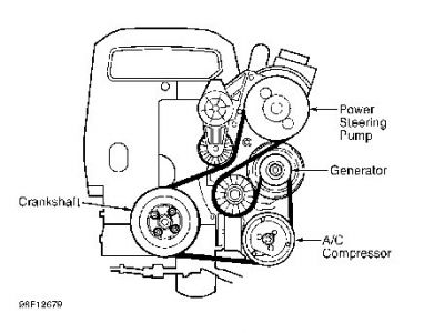

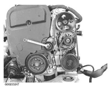

I'm unable to locate a belt diagram to replace the multi rib belt on a 2000 S70. Can someone please send me a diagram or point me in the right direction.
Thanks,
Van
Saturday, September 8th, 2007 AT 11:06 AM
KEN L
MASTER CERTIFIED MECHANIC
43,262 POSTS
Hello, there is 2 choices, here are both of them.
