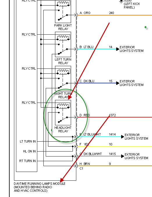

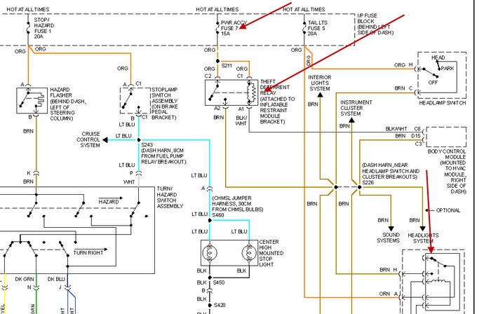

I'm sending a pic along it has 3 arrows to check, one is fuse theother is the power wire going to the drl module to see if and when it gets power. The thrid is the theft deterrent relay as that powers up the drl and headlights. If not then check the multi switch as it may not have a good connection or the pins are loose is about all I can think of without actually seeing this. Esepcially since the coloumn was pulled out of it.

I did check the pwr accy fuse. Ok
I did not locate the theft deterrent relay but. When I arm the car with the remote, the DRL flash and the horn sounds. When the alarm or panic alarm is triggered. The DRL flash and the horn sounds.
I could not tell what the third point is

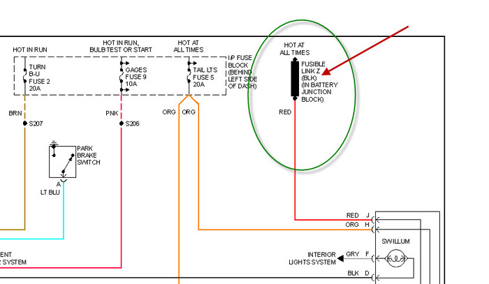

The third point is the drl modle which if they blink when you alarm the car then there power going to it. The only oother thing I can think of without actually searching physically for this problem is to check the fusible link in the junction block underhood as well as headlight relays in the underhood fuse box. By the way ALL camaros and firebirds durign the 90's were made in St theres quebec canada.

Checking for issues today. I noticed my fog light did not flash when I unlocked the car. I confirmed I have power going in/out of the fog light switch. The Fog light do not work. I found the DRL module. On the DRL module, there is a small connector w/8 pins labeled with A, B, C, D, E, F, G, H with B pin location Blank. With power on only pin C has pwr. No other pins has an output. The lager connector w/8 pins is labeled with A, B, C, D, E, F, G, H.
With power on. The Lager connector. Pin A & D pwr
with the Rt turn signal on. Pin B & G pwr
with the Lt turn signal on. Pin C & E pwr
with the head lamp switched to park lamp position. Pins A, D, H pwr. I have not located the Fusable Link as of yet.

The fusible link should be at the junction box underhood, the positive battery lead will go right to it. It may be covered with a red plastic cover that opens. It should be very easy to find.

I started at fuse box, followed the red bat wire. Unraveled the black protective tube all the way down to the electric fans. No fuse.
Under the fuse box I did find 3 fusible links
I check power. On each side of fuse. OK

Othere than the two pictures im sending I have absolutely no idea what other info or diagnosis to give you. Other than to have apro look at it.
