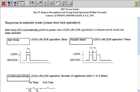

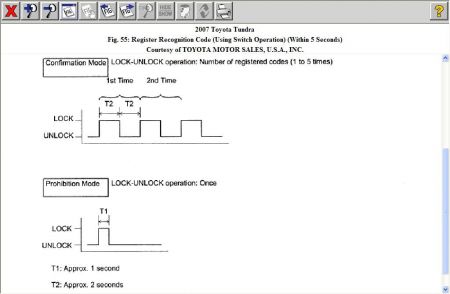

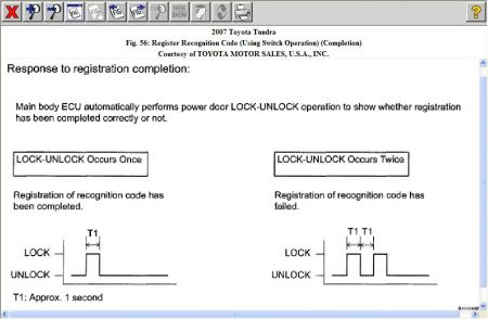

?Can anyone tell me how to program the keyless entry/alarm key fob for a 2007 Toyota Tundra? It is just the standard package, only the "setup" button on the dash board. I have the reset button under the dash that you push to recalibrate the low pressure sensors. Please help me by sending a message to me at jeffwilli@hotmail.com. Thank you.
