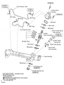

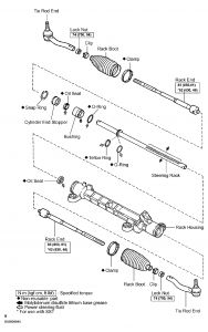

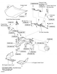

Hi
we're switching out a 1zzfe 2003 engine with a 2006. We need a steering box diagram for the 2003
PLEASE help!

These are the best diagrams I can get.
