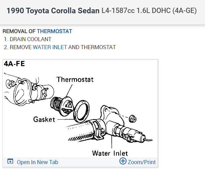

1990 Toyota Corolla 4 cyl Wheel Drive Type unknown automatic 194000 miles
I live in a place where it gets to be -30 and if i let my car warm up for 20 minutes the heat is nice and warm but as i drive around my temperature gage goes to cold and my windows fog up and the air is cold...it get really cold when i drive on the highway at a faster speed than just driving around town. my dad thinks that it is the thermostat. he has already put some card board in the front...but that hasnt seem to help. do you think that it is the thermostat?
thanks,
Dec 9, 2007 at 2:02 PM
  • CAR REPAIR CONTRIBUTOR
  • 75,992 POSTS
The thermostat will do that its a cheap fix replace it and also check your antifreeze protection down to -30degrees.
Dec 9, 2007 at 3:48 PM
  • 54,350 POSTS

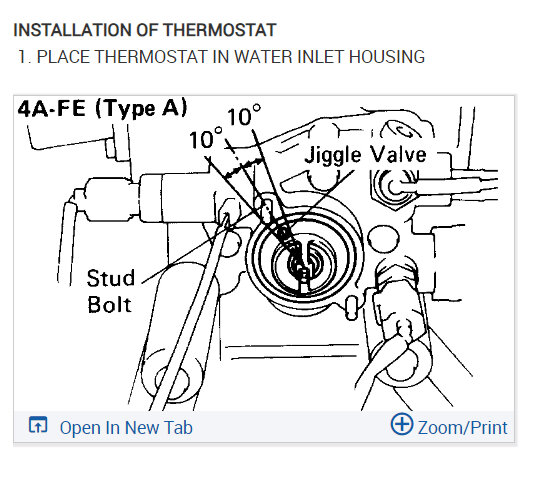

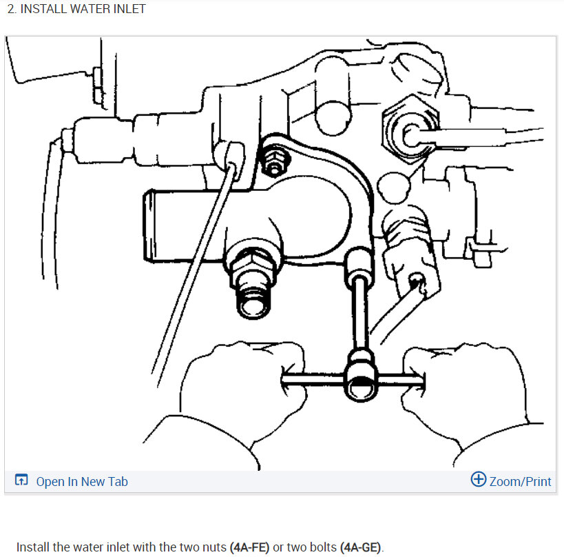

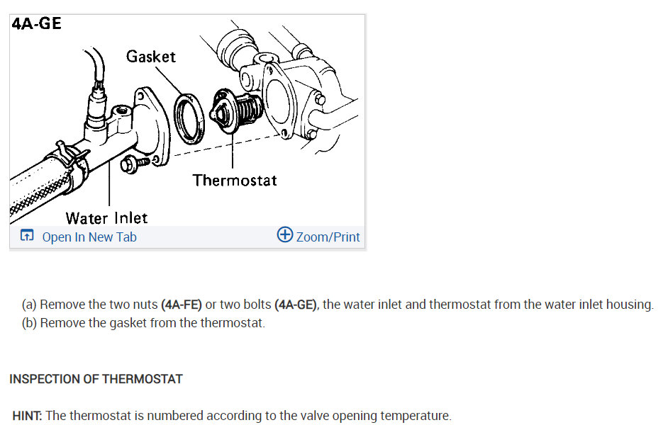

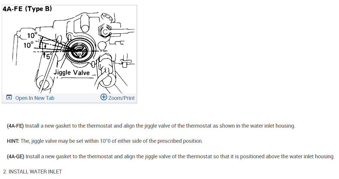

Yep I agree with RASMATAZ, here is how to change the thermostat. Check out the images (below). Please let us know what happens.
