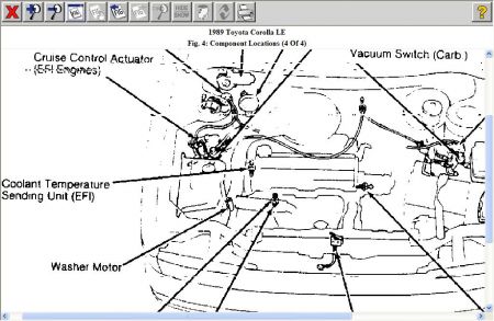

MY FAN DOESNT GO ON WHEN I CONECT IT MANAULY TO THE BATTERY IT DOES WORK BUT CAR STILL HEAT UP FAST TOOK OUT THE T5HEMOSTAT TO SEE IF IT WORKS OR IF WORN DOES NOT WORK PLEASE HELP MY CAR IS JUST STANDING NOW

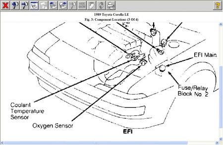

The electric fan should be coming On-if not could be the temperature gauge switch or the coolant temperature sensor when use by the computer to energize the fan relay and then to the fan.
Try direct power to the fan-see if it will operate-

could you tell me where the temp gauge nd the themo sensor would be i will gladly apriciete it thanks
Feb 14, 2008 at 4:00 AM
  • CAR REPAIR CONTRIBUTOR
  • 75,992 POSTS
See illustration below Temperature switch
https://images.2carpros.com/forum/automotive_pictures/12900_temp_switch_1.jpg
Coolant temperature sensor
https://images.2carpros.com/forum/automotive_pictures/12900_cts_6.jpg
