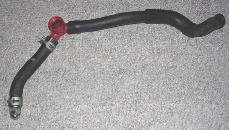

check for wetness on the passengers side carpet or floor mat , it seems the heater core may be leaking internally , if you need a quick fix you could clamp off the heater core hoses or get a 2 dollar bypass hose from the parts store and put both heater hoses on that bypassing the heater core but still having flow everywhere else , as far as the trip keep you eye on the coolant every once in a while , a neglected leak could cost you big if unattended to

I'm very "non-mechanical", and not sure how to manage the by-pass clamp fix you advise (though can presumably figure it out, with a bit of time.)

the bypass fix is minimal you would need a screwdriver and a pair of pliers , its really like a "t"you would take off the hhoses at the heater core located on the firewall and place them on the t with two clamps totally eliminating the heater core and heat?? the cooling system is under constant pressure and the leak may get worse quick or it may not , if you keep and eye on the guages and check the coolant once an hour unless the leak gets worse i would suspect you could make the trip, oh and the doantion is up to you the feedback to me is just saying i helped you thanks jim t inbetween the heater hoses
https://images.2carpros.com/forum/automotive_pictures/59481_MigsHeaterCoreCleaning_04_1.jpg
