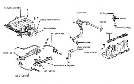

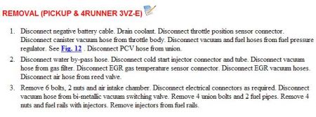

i need to know were the fuel injectors are on the engine because the vehicle will not start we have tested the altinator and the starter and they passed the cords and plugs are good and the engine will try to turn over but just cant do it

HI there, Check that you have injection pulse & fuel pressure first, see pic & text re injectors. Mark (mhpautos)
