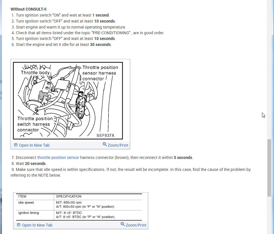

Hi, there if your going to replace the throttle body which is run by cable do you still need to do the relearn procedure?
Sunday, November 15th, 2020 AT 7:36 PM

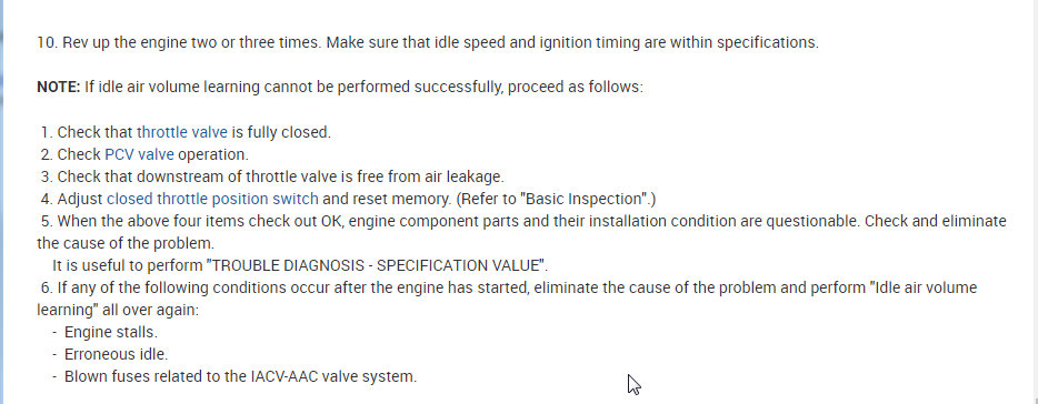

We don't offer the Tino here in the USA so I don't have the manual on that vehicle but it is basically the same as a Sentra with the 1.8L. I attached the relearn process for the air volume which is all that you need to do after replacing the throttle body.
You can do this with a scan tool but I assume you don't have one so I attached the process to do this without the tool. Let me know what questions you have and we can go from there. Thanks
