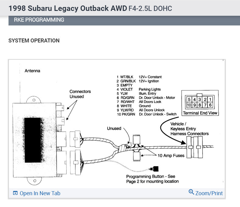

Car is equipped with keyless entry. Battery in the car was replaced and the factory remote battery stopped working. Purchase a new compatible remote but the car just won't go into the programming mode. Held the programming button for 20 seconds with the key in the on position but the door locks never cycle.

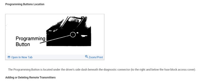

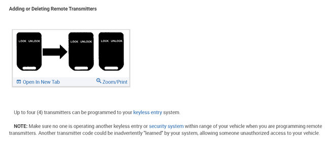

Here are the instructions on how to add a key remote in the diagrams below. Check out the diagrams (Below). Please let us know what happens.

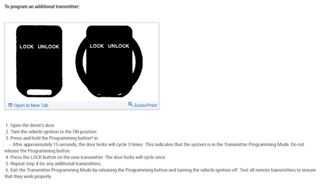

Heres the instructions to program your remotes
1. Open the driver's door.
2. Turn the vehicle ignition to the ON position.
3. Press and hold the Programming button* in.
-. After approximately 15 seconds, the door locks will cycle 3 times. This indicates that the system is in the Transmitter Programming Mode. Do not release the Programming button.
4. Press the LOCK button on the new transmitter. The door locks will cycle once.
5. Repeat step 4 for any additional transmitters.
6. Exit the Transmitter Programming Mode by releasing the Programming button and turning the vehicle ignition off. Test all remote transmitters to ensure that they work properly.

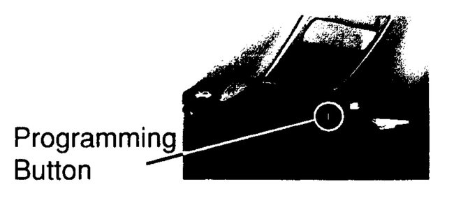

The Programming Button is located under the driver's side dash beneath the diagnostic connector (to the right and below the fuse block access cover).
See image below
