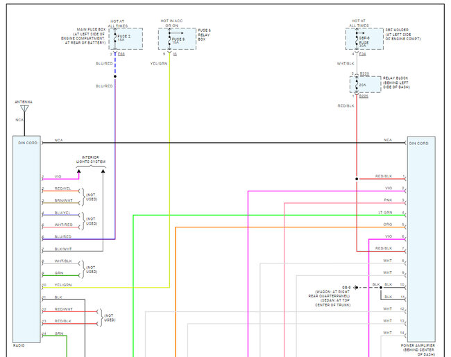

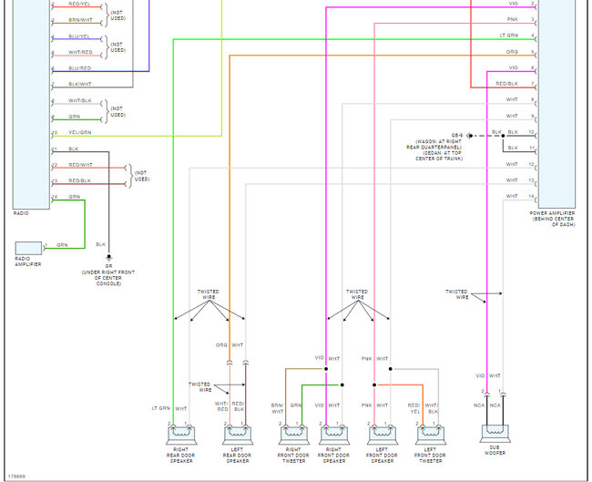

HAWAIIAN75
my car has no amp or a relay sbf8 spot but all my speakers do not give sound?
Jul 30, 2024 at 4:34 PM
  • CAR REPAIR CONTRIBUTOR
  • 54,350 POSTS
If you don't have an amp chances are the radio head unit itself is probably bad. Here is the wiring diagrams so you can see how the system works and which fuses to check. Check out the images (below). Let us know what you find.
