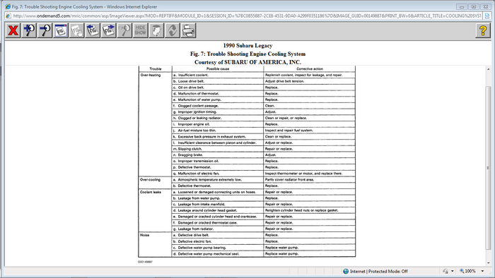

I have replaced the thermostat twice, put in a new water pump, replaced the radiator, replaced the head gaskets twice, and it still overheats. It will over heat and the heater will be putting out cold air, then the heater will come on. The radiator will sometimes overheat and overflow into the overflow bottle, but at the same time one half of the radiator is hot and the other half is cool to the touch.
Wednesday, March 13th, 2019 AT 5:53 PM (Merged)
  • 75,992 POSTS
Hi DennSubaru and TY for the donation
but at the same time one half of the radiator is hot and the other half is cool to the touch. It shouldn't be-should equally be hot across the radiator. That coolant is not circulating. Take the thermostat out and run it if its still doing it make sure the water pump is doing its job if it is-try bleeding it for airlock and report back
Water pump check:
One way to test for a bad water pump is to squeeze the upper radiator hose when the engine is hot and idling. Careful, because the hose will be HOT! If you do not feel much coolant circulating through the hose when you rev the engine, the pump may be bad. The other cause might be a bad thermostat that is not opening properly (remove and inspect the thermostat), or a clogged radiator.
