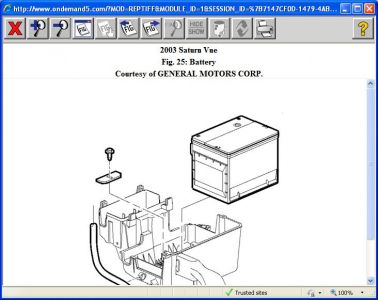

Problem is, I can't get the damn battery out. I think it's bolted to the tray on the under side. So I can't get it out, I can't jump start it, I can't drive it to an Autozone so they can help. What am I supposed to do?

Any help on how to remove the battery would be greatly appreciated.

At the base of the battery there is a block with a bolt holding ur battery down remove the bolt and block and the battery comes right out. Let me know what comes up with the battery test and all that.

https://www.2carpros.com/forum/automotive_pictures/416332_2003_vue_battery_1.jpg

Thanks for the awesome image! I had to get help from a friend with smaller hands to remove that piece, but I got it out in the end.
Also, I did have to go buy a socket wrench set with a pretty healthy extender to remove that bolt.
Took the battery to Autozone, they charged it for an hour (which I figured they wouldn't need to do) and they announced it was dead.
After hooking up the new batter the car started like a dream! I will still take it by Autozone to test the starter and the alternator to make sure they aren't draining the battery.
