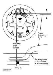

I'm looking to know if it easy to change the rear brakes in a 2002 saturn vue.
I jacked up the suv and removed the tire and noticed that the drum cover wont come off. Do I need to remove the large nut thats in the middle or should the drum come right off.

No! DISC & DRUM -2002 Saturn Vue
Page 1 of 2
REAR BRAKE SHOES
Removal
1.Raise and support vehicle. Rear wheel. Remove brake drum. If drums are difficult to remove, insert a thin screwdriver through hole in backing plate. Hold adjuster lever away from star wheel. Rotate star wheel to contract shoes. See Fig. 4.
NOTE: Do not over stretch adjuster spring. Damage can occur if spring is over stretched.

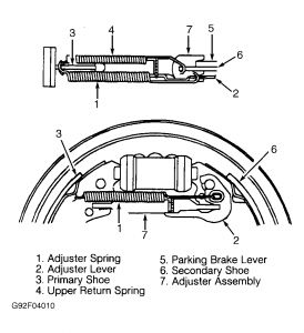

2.Disengage adjuster spring hook end from tab on adjuster actuator. Remove straight end of adjuster spring from brake shoe. 3.Remove adjuster actuator from brake shoe. Remove return spring from brake shoes. Remove parking brake cable from actuator lever. Remove brake shoe hold-down springs and retainers from brake shoes. See Fig. 5. 4.Remove adjuster from brake shoes and parking brake actuator lever. Remove horseshoe clip retaining parking brake actuator lever to brake shoe. Remove parking brake actuator lever and wave washer from brake shoe. 5.Clean all of the drum brake system components with denatured alcohol. Inspect all of drum brake system components. Replace drum brake system components as necessary. Inspect wheel cylinder for brake fluid leakage, or worn or damaged dust boots. Replace damaged or leaking wheel cylinders as necessary.
Fig. 4: Contracting Rear Drum Brake Shoes Courtesy of GENERAL MOTORS CORP.
Fig. 5: Identifying Self-Adjuster Components (Rear Drum Brakes)
