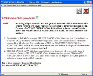

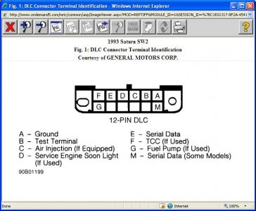

I have never had any luck cleaning those egr valve's they stick at the opening and they stick open which mean's the pintle or the shaft stick's and cleaning that is impossible.Your best bet would be to change it with a new one.I posted how to retrive code's let me know what code's you have.
https://images.2carpros.com/forum/automotive_pictures/416332_1993_SW2_code_retrival_part1_2.jpg
https://images.2carpros.com/forum/automotive_pictures/416332_1993_SW2_code_retrival_part2_3.jpg

yeah, i keep a paper clip in my car for this very reason, lol. but the engine light usually goes off after 30 seconds or so, i can never seem to catch it. and I haven't seen one in weeks.
Jan 22, 2019 at 11:35 AM
SATURNTECH9
  • CAR REPAIR CONTRIBUTOR
  • 30,869 POSTS
There will still be a code stored find out what it is.
95SATURNSL2
  • 16 POSTS
just kept flashing 12.

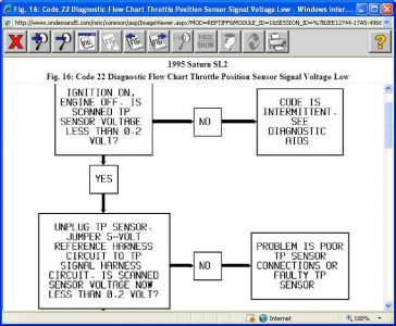

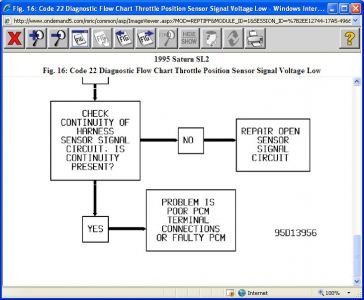

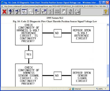

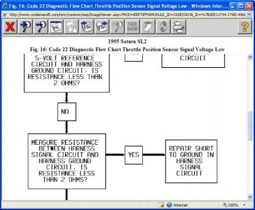

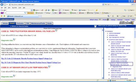

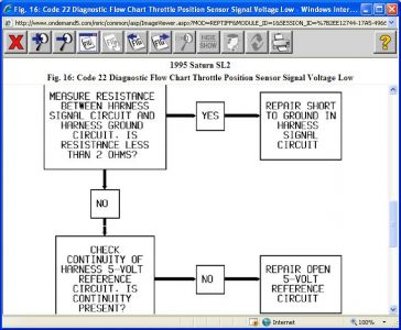

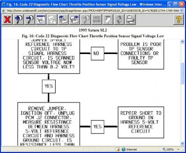

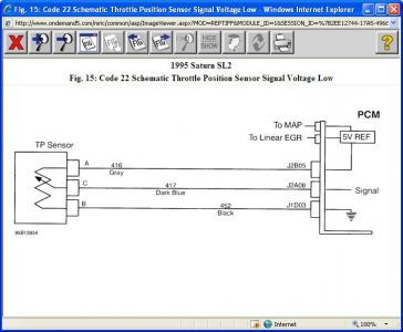

i was going over the bridge, and the check engine light finally came on again. i pulled over and checked it with the paper clip trick, got code 22. is this the tps? the revs would drop and bounce, down to 400, then when the light went off, it would resume high revving at idle.

https://images.2carpros.com/forum/automotive_pictures/416332_1995_sl2_code_22_part1_1.jpg
https://images.2carpros.com/forum/automotive_pictures/416332_1995_sl2_code_22_part2_1.jpg
https://images.2carpros.com/forum/automotive_pictures/416332_1995_sl2_code_22_part3_1.jpg
https://images.2carpros.com/forum/automotive_pictures/416332_1995_sl2_code_22_part4_1.jpg
https://images.2carpros.com/forum/automotive_pictures/416332_1995_sl2_code_22_part5_1.jpg
https://images.2carpros.com/forum/automotive_pictures/416332_1995_sl2_code_22_part6_1.jpg
https://images.2carpros.com/forum/automotive_pictures/416332_1995_sl2_code_22_part7_1.jpg
https://images.2carpros.com/forum/automotive_pictures/416332_1995_sl2_code_22_part8_1.jpg
Code 22 is tps sensor it is also 2nd gear ratio error but sound's like you your looking at the tps code.I posted a trouble tree for it.

well, i managed to fix the high idle for the most part, there were some faulty wire spices behind the TPS (doh!) and the start problem was just a ot of buildup on the terminal (couldn't see it at night, didn't have a flashlight.) now i've got some orange, frothy coolant. i;ve mostly just been filling it up with water because i've got a slow leak. then one day when i got off the highway i went to check it. my coolant was a little low and i had orange frothy coolant! someone told me it may be a symptom of a blown head gasket, i'm a little worried. are there any tests for this? and what else might it be? i haven't noticed any performance problems yet at all, in fact i thought it had been driving much smoother than normal.
