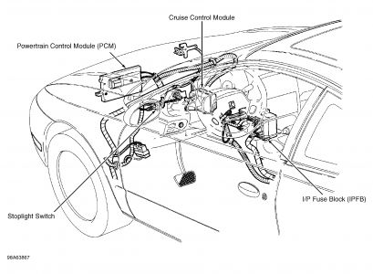

Can't find where hazard light is so can replace it
turn signal and hazard light went out same time

The flasher module is located in the I/P fuse block, behind the center of dash
