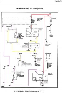

http://www.2carpros.com/forum/automotive_pictures/416332_img019_1.jpg
theres a wire diagram for the starting circuit u should have power all the time to the red wire as u can see then when u turn it to the start postion the power goes to the solid yellow wire no tracers on that one.ur best bet is remove the ignition housing covers it takes a 5.5mm nut driver to take them off and once u get the top cover off then put the ignition key in the acc postion push the top square button under the cover right above the cyclinder then remove the cyclinder then remove the lower cover and put the cyclinder back in so u can put the key in the start postion to test that yellow wire right at the switch.let me know if theres power right there off the switch at the yellow wire then we will trace down from there.

Ok best I can telll there is no power at the yellow wire. I cant really read the diagrahm. Is there anyway you could email it to me at rthompson731@yahoo. Com. Thnks for all your help

I emailed u the diagram u really should check the yellow wire at the igniton switch because depending on where u check it and dont have power will lead us to a differnt path of diagnoses. If u have power on the red wire at the switch then turn it to start and dont have it at the yellow wire at the switch then u have a bad switch as u can see from the diagram. But if u go further down by the starter relay and loose the power on the yellow wire then it could be the relay or ur antitheft. Do u have keyless entry?Let me know and what u find on the wires.

Well the diahrahm makes more sense now that I can actually read it :). OK I DO have power at the yellow wire at the switch. I think that the diagrahm is for auto matic though will that matter? Anyway where will the starter relay at?

Take another look at that wire diagram I sent u print it so u can take it to the car with u. It shows both automatic and manual on there follow the yellow wire down to the starter relay it even tells u where the relay is on the diagram. The yellow wire goes thru the relay then to ur clutch switch. But as u can see the starter relay is turned on by the ground under ur drivers seat or by ur rke module.I aske again do u have keyless entry it matters when we get that starter relay. Check terminial a2 c1 c2 of the starter relay when the ignition switch is in start postion they should have power if they do the relay is working. Let me know what u find and what has power and what doesn't.
