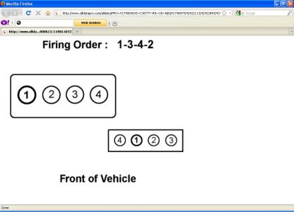

https://images.2carpros.com/forum/automotive_pictures/416332_1996_sc2_spark_plug_wire_1.jpg
On your starting concern have you checked and made sure your battery cable's are clean and tight?Also have you had your battery and alternator tested?Have you made sure that all the connection's to the starter are tight you said you moved the starter so i would check all those connection's.Also what kind of plug's did you put in?When you replaced the wire's are you sure they were routed correctly?I would check those for sure.Also another thing that fails a lot on those cars is the coolant temp sensor there only 10.If you replace it make sure you get a brass tipped one the plastic tipped one's crack.Also inspect the connector going to it if it's corroded then you will have to replace the connector.On the diagram i posted the big one is the engine and the little one is the coil all you have to do is match up 1 to 1 2 to 2 3 to 3 and 4 to 4.All so can you get me that code number that keep's setting
