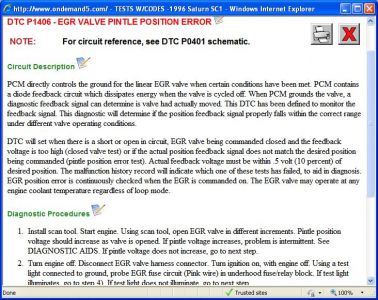

hiya louie i got scanner and troubleshooter today had to go find batteries lol but i got p1406 code off the saturn i havent got trailblazer here atm. the scanner has no definition for p1406 and i got no service manual :/ so im back to square 1. ill be trying to get service manual asap. any ideas?
May 18, 2010 at 6:00 PM
SATURNTECH9
  • CAR REPAIR CONTRIBUTOR
  • 30,869 POSTS

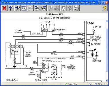

https://images.2carpros.com/forum/automotive_pictures/416332_1996_sc1_egr_diagram_1.jpg

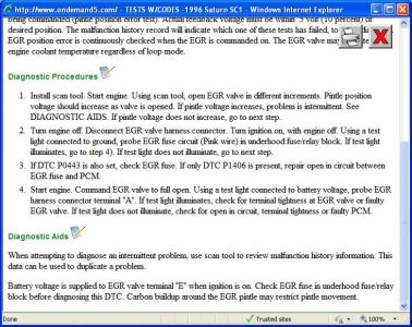

https://images.2carpros.com/forum/automotive_pictures/416332_1996_sc1_p1406_part1_1.jpg
https://images.2carpros.com/forum/automotive_pictures/416332_1996_sc1_p1406_part2_1.jpg
I posted the wire diagram for your egr valve and also the trouble tree for your code p1406 its a egr valve code.If you could look at your malfunction history with the code p1406 and tell me what the egr actual verus desired postion/voltage was basicially how the two compare.Also key on engine off tell me by looking at your engine data stream what the egr valve is sitting at postion percentage and voltage.Also which scanner did you get?hopefully it does engine data display.let me know what you find.

Here's what you do turn the key to the run postion don't start the car.Select domestic vehicles select general motors.Select car select 1996 select Saturn select sc1 select 7 select keep press enter select diagnostic codes select freeze frame data find your egr code then scroll thru the data.press the back button twice then select data stream then view data.Then entire data list Iam sorry I miss led you it doesn't show the egr data on data stream.But look in freeze frame data at the egr code an see if it shows it there.Iam still getting use to this scanner.I use to use that 4,000 plus scanner every day and that one does every thing.Let's also do this take the egr valve off turn it up side down get a small pick or screw driver and push on the star shaped center of the plunger of the valve.See if it sticks at first then release's bottom it out then slowly release it did it stick open?let me know what you find.

I removed the egr and it was stuck at first but broke loose and worked smoothly afterwards so I reinstalled it and erased the codes to see if it would show up again, but when i tried to start the car the fuel pump relay started clicking and all the dash lights were really dim and flashing and the radio was locked like the battery had been taken loose and the car barely turns over and wont start now. Have i really screwed up now?

If the egr valve was stuck then that's what caused your p1406 the bad news is you can try cleaning it but more then likely you will have to replace it so the code won't come back.Now let's talk about your dead battery first make sure your battery cable's are clean and tight.If they are clean and tight and it still won't start see if you can jump start it.If it jumps then let it idle for about 10 min's then turn the a/c on and head light's on high beam.Then get a volt meter and see what it's reading at the battery at Idle.If it won't jump start take the battery out and take it to the auto part's store and have them charge and test it.If it test's good then put it back in the car.If ut test's bad get a new battery and put in the car.Then start the car and and do the volt test like I just explained.Let me know what you find.
