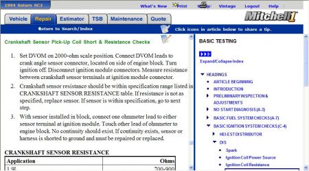

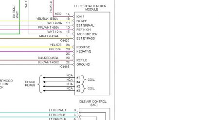

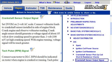

Okay lets try sparky-test the crankshaft position sensor's resistances and its output AC voltage-see below to include the ignition control module.
https://www.2carpros.com/forum/automotive_pictures/12900_cps1_2.jpg
https://www.2carpros.com/forum/automotive_pictures/12900_cps2_1.jpg
https://www.2carpros.com/forum/automotive_pictures/12900_ICM_1.jpg
