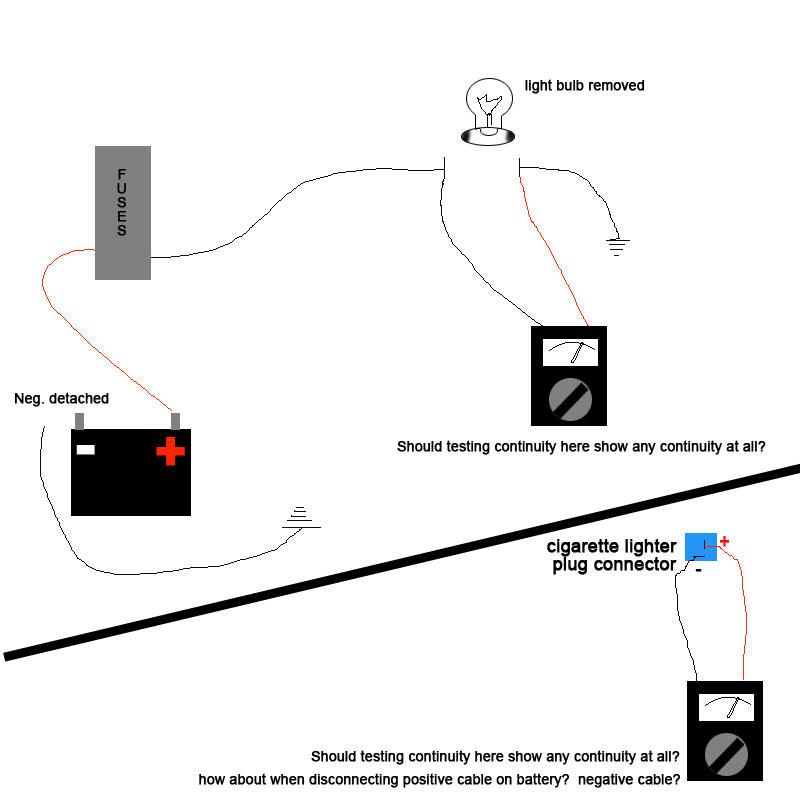

So, the driver's power seat stopped working. Checked and found its fuse (20A) blew. Replaced fuse and seat worked just long enough to move it so I could at least fit in to drive, but then blew again. Bought some fuses and replaced it again. This time it was blown before I could even move the seat at all (key not in, seat normally works with out key). Had lots of fuses so tried another. Blown.
Bleh.
So now I've been researching how to track down a short. But I keep getting confused.
First I thought it may have been the power seat switch (because my multimeter's continuity gave different tones when testing the 8-way plug after I removed the switch completely). But a new-ish switch I bought off eBay also behaved exactly the same way on multimeter.
Now I'm trying to use multimeter to narrow down where short is happening.
Question: if I disconnect negative cable from battery, should I get ANY continuity reading at all when testing between the neg/pos holes of a cigarette lighter connector plug? Because I do. Even though it's not full continuity as you get when touching the multimeter's probes together. It's close though.
I couldn't understand why that should happen, so I tried the same test elsewhere. Pulled the light bulb out of the passenger's door, and tested either side of the plug it went in. Same. Seeing continuity with neg cable off battery (pos. Cable still attached).
Shouldn't there be no continuity between neg and pos points on a device plug? Especially if neg. Battery cable is detached.
What to do? Test between power seat switch plug and fuse holes?

Well, I don't think it would cause the clock issue, but it does lead me to believe there is a short to power somewhere in the system. As far as an electrical draw, have you checked for one? Have you ever had trouble with a battery going dead over night?

What should the result be for the following scenarios:
1. Both POS & NEG cables CONNECTED to battery. Test for continuity on any device's two contact points (e.G. Disconnect cigarette lighter socket and test connector plug, or remove light bulb and test contact points).
2. POS cabled DISCONNECTED, NEG cable CONNECTED. Same continuity test. (Note: I've done straight continuity. Sometimes don't get a tone, but if I switch to Ohms I can see it does have lowered resistance, i.E. Some continuity.)
3. POS CONNECTED, NEG DISCONNECTED. Same test. Should there be a difference?
Saturday, May 17th, 2014 AT 10:18 AM

As far as the test, when you check continuity, you are doing nothing but checking to see if there is a continuation of power through a conductor (the wire). Honestly, that shouldn't change.
If you remove a light, for example, you have opened the circuit and there should be NO continuity from one contact to the other (battery connected or not), Is that what you are seeing?

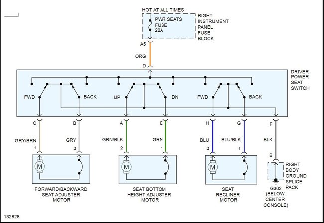

I have attached the wiring diagram for the seats below

I should go test it one more time now that everything is put back together and running "normally". But, yes, my multimeter registered "some" connectivity between two contact points of an empty cargo light socket on the passenger door (as well as on a cigarette lighter plug for the back seat, on back of center console).
Don't remember if it actually beeped on continuity setting, but did show a charge in ohms on other setting.
