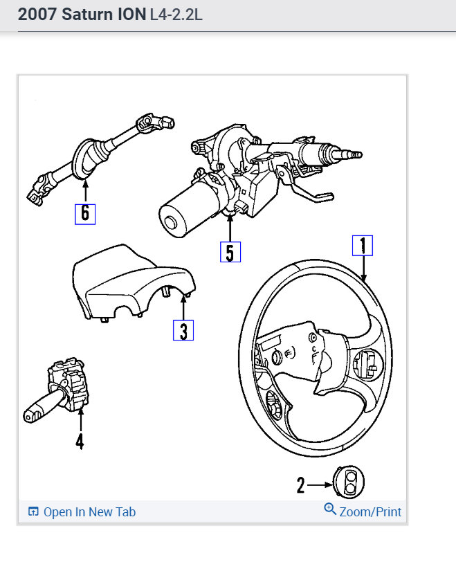

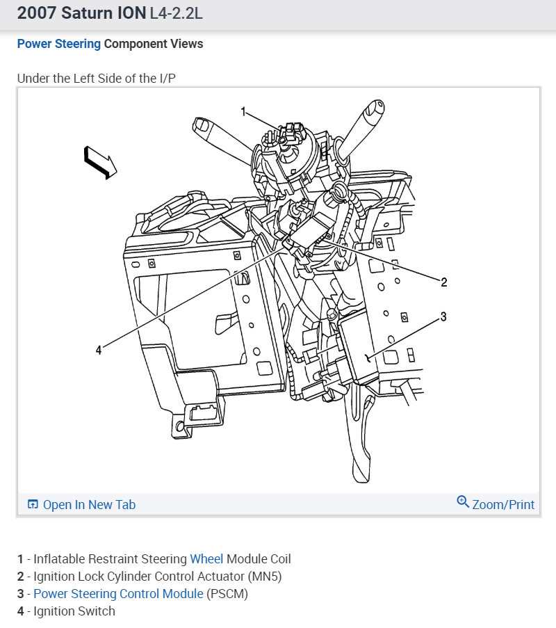

I drive a 2007 saturn ion and this has been happening on and off for quite some time. Every once in a while my car will display "PWR STR" and my power steering will go out even though there is fluid and is working prior. But when I turn off then restart the car the issue will go away USUALLY. But now recently my battery died yesterday and when I got the car started "PWR STR" issue once more and now will not shut off and is ver trying to turn car. Help?

Your car has electric steering there is a motor on the steering column to give you power steering. Since you changed the battery or jumped the battery and now your power steering is totally inop I bet you blew a power steering fuse. Look in your under hood fuse box you will see some square fuses with a clear window on top check all the fuses you will be able to tell if there blown by looking thru the clear window compare them to each other. The intermittent no power steering is another issue that you will have to have your Power steering control module cleared for codes and then recheck it for codes after you loose power steering. That is if you blew a power steering that code set codes falsely. I have seen the module or the motor go out on these cars. Check the diagrams below to see how the system works. Check out the diagrams (Below). Please let us know what you find.

Sounds like u have a bad power steering motor that's the most common reason for that pretty common. It goes on the bottom of ur steering column. They sell it seperately now u used to have to get the whole column. Have ur power steering module scanned for codes and we can go from there. Let me know if u have anymore questions.

What switch are you having problems with?Also whenthe steering goes out if yyou cycle the key does the steering come back on?If so you will have to have your power steering control module scanned for codes. It will take a professional scan tool not a diyer scan tool. You need on that can read all the computers in your car. Then let me know the exact code number you have not code descriptions. It will be a letter followed by four numbers. Then I can tell you whats going on. Most likely a bad steering motor but might need the steering module.
