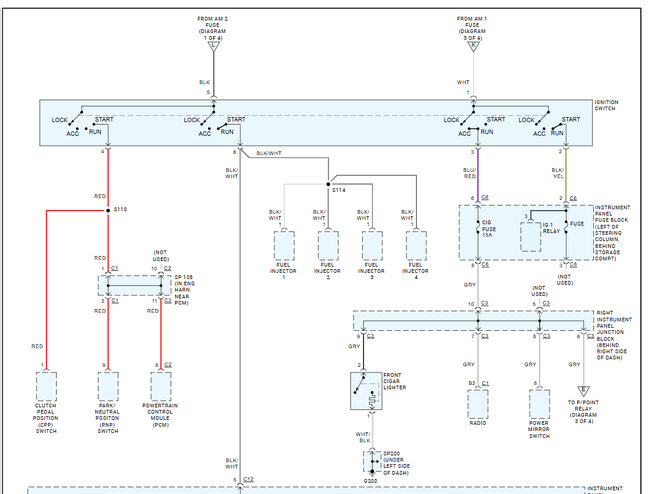

Electrical problem
2003 Pontiac Vibe 4 cyl Front Wheel Drive Automatic 109k miles
dash doesn't light up, list of things with no power. moonroof, radio, heater/ac, windows ,locks, wipers, lights, engine starts up cannot get it out of park. please help.thanks.

Hi
check fuse link BLUE coming off battey POS use test light see if power is on both sides. Has car been jump started lately? Battery changed?

AKERS35
checked fuseable link,has power both sides.i charged battery.

Been out of town checking up on last posts. I have checked over wiring diagrams till my eyes crossed can't find anything common except for BLUE fuse link. What is status? would like to know

HUNTER82
Any more information I am having the same symptoms. Just happened last night. I will check the blue fuse link tonight.

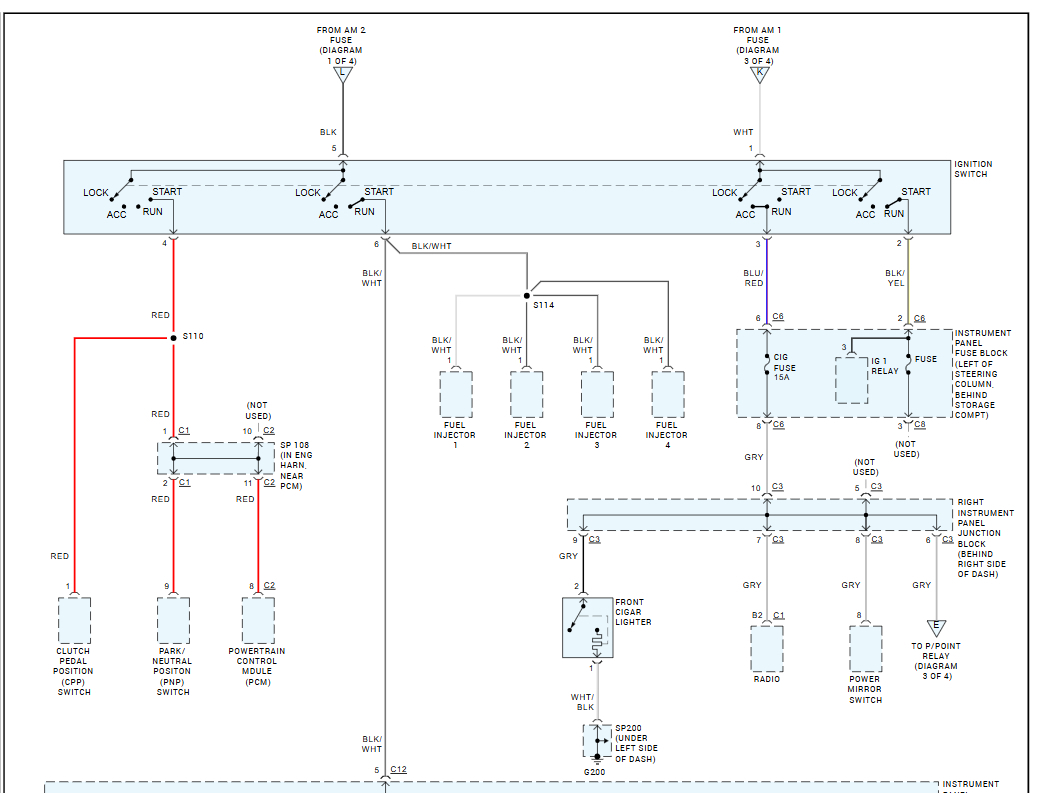

I would, but to me it sounds like the ignition switch has gone bad, here is a guide to check the output wiring of the switch and a diagram below to show you which wire to check for power while the ignition switch is on. Check the Blu/red and the blk/yel wire.
Check out the images (below). Let us know what you find.
