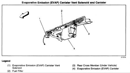

Where is the fuel fillter located on the 2002 Pontiac Sunfire SE?

The fuel filter on a 2002 Pontiac Sunfire is under vehicle, in the rear between the fuel tank and the rear axle.

The fuel filter is located on the cross member just forward of the fuel tank.
