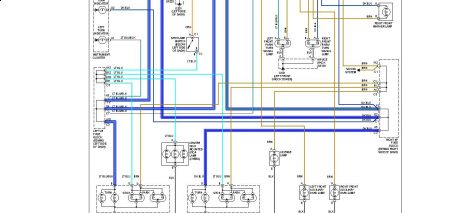

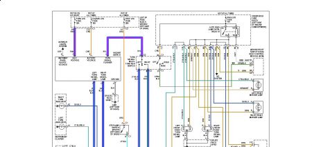

Could be an open bulb that's causing it to blink fast, overall get the turn signal/multifunction switch tested-
https://images.2carpros.com/forum/automotive_pictures/12900_s1_26.jpg
https://images.2carpros.com/forum/automotive_pictures/12900_s2_25.jpg

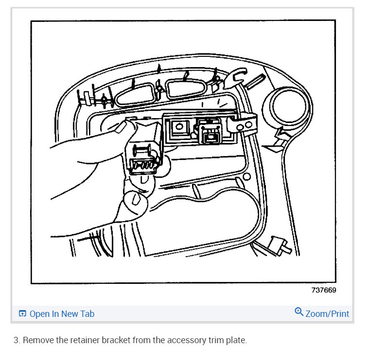

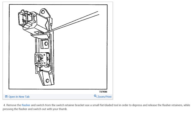

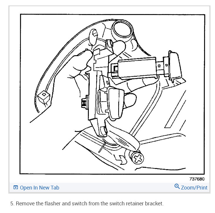

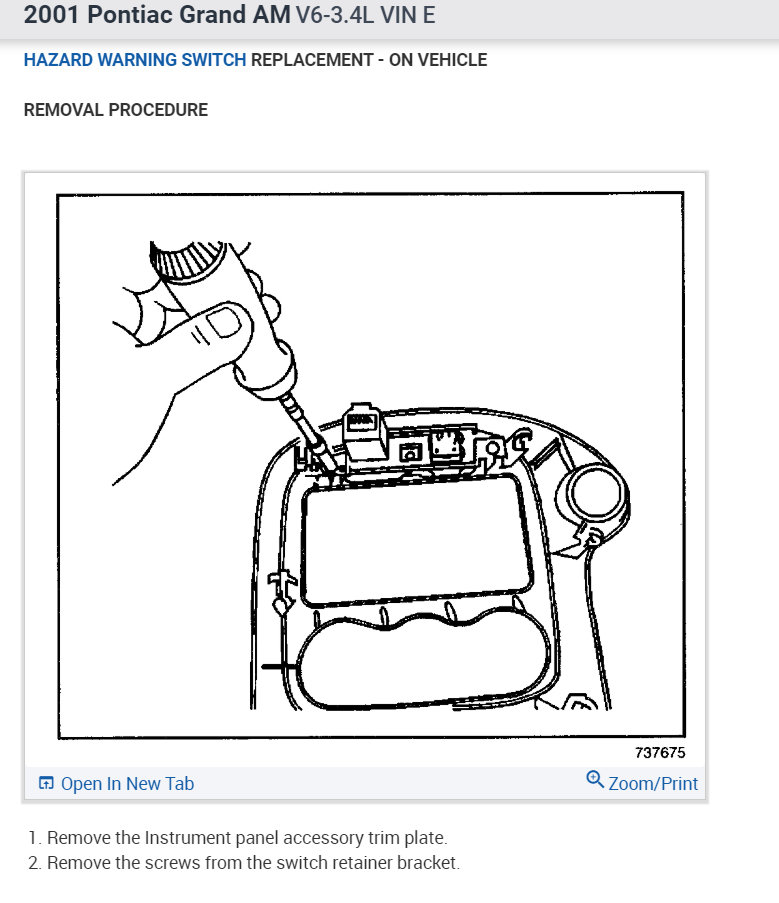

  • CAR REPAIR CONTRIBUTOR
  • 54,350 POSTS
This is because the hazard switch needs to be replaced here are instructions on how to do it in the diagrams below. Check out the diagrams (Below). Please let us know if you need anything else to get the problem fixed.
