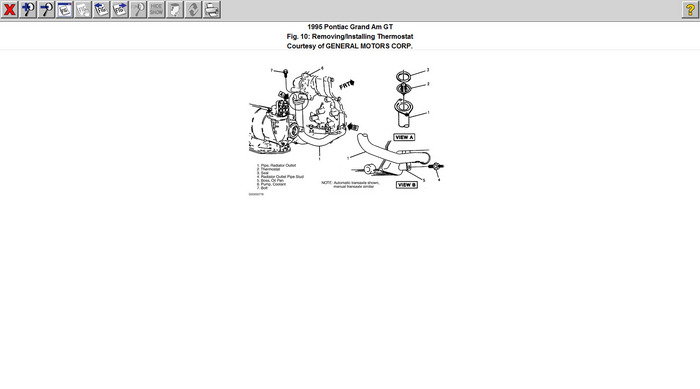

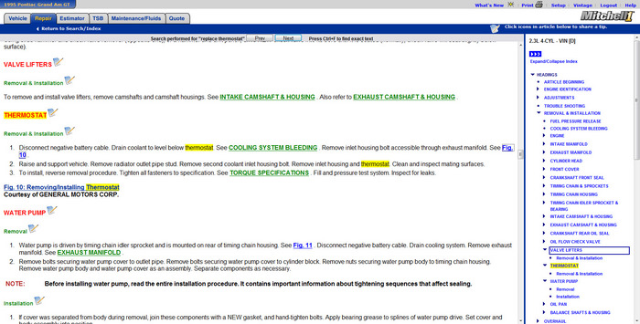

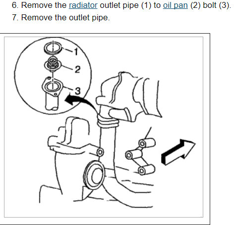

My thermostat is leaking coolant. I want to change it myself. I know where the thermostat is located and know that I should only remove one bolt and just loosen the other. However, there is a metal line (not sure what it is) that appears to be firmly in place that runs from the housing.
Replaced thermostat and reassembled. Drove maybe 2 miles and car wouldnt heat up fully so left it running for about 10 minutes in park and it began overheating so I shut it off got out and all the antifreeze just added had leaked out, had it looked at again and whatever was done stop the leaking but now it was sputtering and getting hot to the third quarter line and felt as if wanted to die while it stayed idling at the 2 mark. Serbice engine light came back on so had it re diagnosed this time showing thermostat o2 sensor and random misfire, had it taken apart and thermostat checked fixed gasket that had been broken during the initial thermostat replacement and replace vacuum hose, reassembled and sounds normal but now is running hot and leaking fluids under the antifreeze container, person working on it says its the water pump but it was not doing this initially before it was services the first time, does this sound right? How did the water pump fail all of a sudden?
My question is: Should I remove this line? If so, how?

Heloo, This guide will give you an idea of what you are in for when doing the job along with diagrams on how tot do the job on your car (Below) https://www.2carpros.com/articles/replace-thermostat
https://images.2carpros.com/forum/automotive_pictures/198357_Graphic_578.jpg
Check out the diagrams (Below) Please let us know if you need anything else to get the problem fixed. Cheers

  • CAR REPAIR CONTRIBUTOR
  • 75,992 POSTS
REMOVAL
Negative battery cable.
Drain and recover the coolant.
Air clearer assembly.
Surge tank line from coolant outlet.
Coolant outlet to inlet manifold attaching bolts.
Coolant outlet.
Thermostat.
Clean
Inlet manifold mating surfaces.
Coolant outlet mating surfaces.

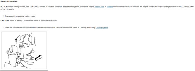

I have a 1995 Pontiac SE 2.3 L Grand AM, and I am replacing the thermostat in it. Please tell me what all I have to do to get at the thermostat? What is the easliest way? Thank you!

here is a picture and instructions, 2 pictures........hopefully it shows up if not let me know...

A little tricky follow diagram

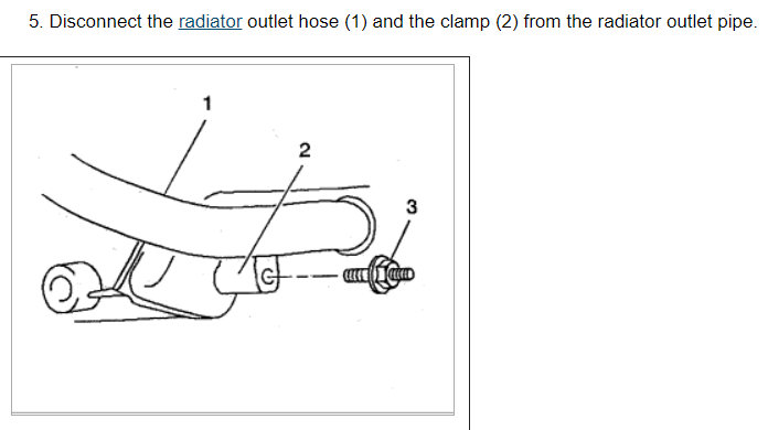

I am wanting to get help with replacing the thermostat for a 1999 pontiac grand am.

REMOVAL:
Drain the cooling system.
Remove the air cleaner.
Remove exhaust crossover pipe.
Disconnect the surge tank line fitting from the coolant outlet.
Remove the thermostat housing to intake manifold bolts.
Remove the thermostat housing outlet and thermostat
Clean the mating surfaces.
INSTALLATION:
Install the thermostat and housing outlet.
Install the thermostat housing bolts. Tighten the thermostat housing bolts to 18 ft. lbs. (25 Nm).
Install exhaust crossover pipe.
Connect the surge tank line fitting to the coolant outlet. Tighten the fittings to 15 ft. lbs. (21 Nm).
Install the air cleaner.
Fill the cooling system.
Inspect the system for leaks.
Let me know if you need further assistance..

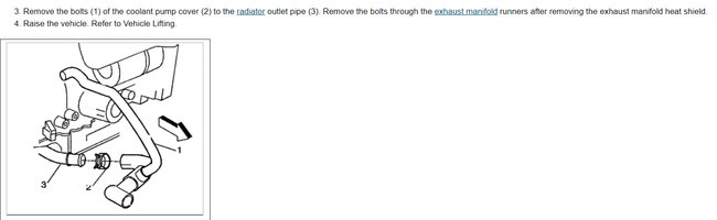

how do i locate and change the thermostat

you would prob have to take off the water pump to change it, but your water pump has like a metal hose running from it that runs underneath the oil pan, but it is an metal hose that meets up with your water pump the thermastat is between water pump and the hose.... for more info LMK...

REMOVAL:
Remove the exhaust crossover pipe
Remove the thermostat housing outlet and thermostat.
INSTALLATION:
Install the thermostat housing bolts and tighten to 18 Ft. Lbs. (25 Nm)
Install the exhaust crossover pipe
Connect the surge tank line fitting to the coolant outlet and tighten fittings to 15 Ft. Lbs. (21 Nm)
