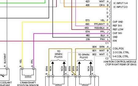

Car is running on 2 cylinders. I removed the assembly of the coils and ignition module and turned it upside down. Installed normal wires from the this assembly down to the plugs. Started the car and used a timing light to determine that the first and last cylinders are not firing and that the car is running on the 2 center cylinders. Used an ohm meter to determine that both cylinders that are not firing were going to the same coil. Assumed the coil was bad and replaced it. No help. Swapped the location of the 2 coils and still the same cylinders don't fire. Installed a new ignition module, still the same problem. I have checked the wiring harness that conects the ingnition module to the coils with an ohm meter, it seems OK, all circuits read about 0.2 ohms. I checked the resistance of the individual plug circuits inside that white plastic cover that the coils mount in. Each read about 1.2 ohms. I am at a loss.

hi, thanks for the donation. Did you check the coil grounds, one ground for each coil, one is white, the other is orange, that's how the computer controls the coils.

The wiring harness from the ignition module to the coils has 3 wires. A brown that goes to both coils and 2 whites, one going to each coil. All 3 read ok when checked with an ohm meter.

The white and orange wires at the top of ignition module. There has to be a pulse, You can take connector loose at both ends, pcm and ignition module, then check continuity. You may need to check for codes, at the least, you need an obd11 code reader.

I'll check the white & orange wires for a pulse. Problem should be on pin A which controls cylinders 1 & 4 because they are the 2 that don't fire. What type of pulse should I be looking for? Is it 5V, 10V? What is that pulse referenced to, ground or another pin? Can I read it with a volt meter or do I need an O-scope?

Hi, you have the 2.4? Use a spark tester on plug wire that isn't firing. Then, can take the connector loose from pcm, use a testlite connected to battery voltage, key on, probe the terminal for the white wire, if the tester sparks, everything from the test point to plug should be ok.
The P1336 says the pcm needs crankshaft variation relearn procedure.
P0342 is cam sensor counter, not incrementing. Your getting to the point, I'd have to look at it.

The problem is solved. I spoke with a local mechanic and he told me the resistance check I did on the white plastic housing / cover that the coils mount in was useless. Even though they read as a good circuit when measured with an ohm meter, they can still not work. Based on his advice I bought a replacement, installed it and the car runs fine.
